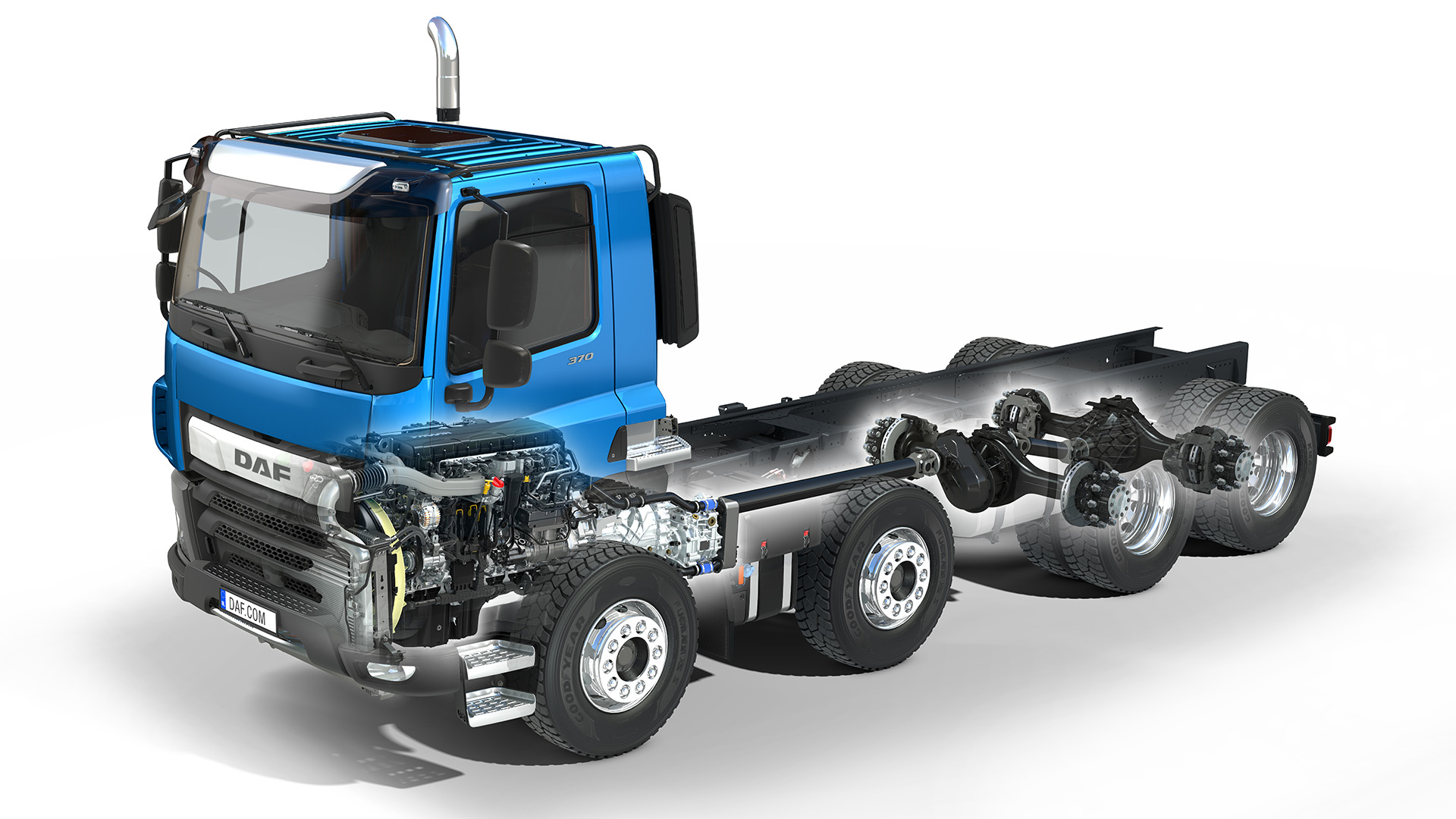

New ultra-compact EAS: extra chassis layout options and extra payload
The new rigid chassis benefits from the ultra-compact EAS of the New CF and XF. The EAS can now be fitted in its entirety (i.e. as one single unit) between the first and second front axles (in the 8x4 FAD). This makes it possible to use the free space for the addition of crane legs, toolboxes or extra (fuel) tanks and results in increased frame layout options and extra payload, thanks to its 50 kg lower weight.

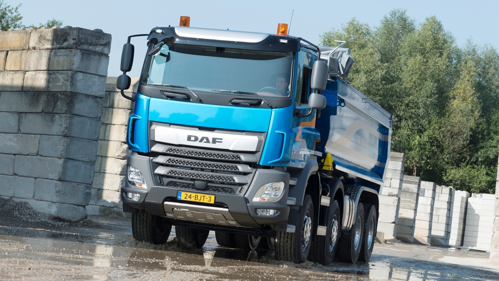

For vehicles that regularly drive off-road, DAF is presenting a new double-driven tandem with hub reduction (HR1670T). This axle set boasts a completely new cast-iron axle housing that provides an extra weight reduction of 60 kg.
In order to achieve the highest possible fuel efficiency, even faster final drive ratios (3.46, 3.61, 3.76:1) are available. These ratios allow the engine to operate at even lower revs. To ensure the lowest possible operational costs, oil-change intervals for the new tandem set have been raised to 3 years or 450,000 kilometres.
The new dual driven tandem with hub reduction is available on 6x4 and 8x4 tractors and rigids for heavy duty applications. This range includes the FAD 8x4 rigid with two steered front axles commonly used in the transportation of sand and gravel. In this model the SCR unit is no longer integrated in the vertical exhaust. Instead it is in the new EAS unit, which thanks to its compact dimensions can fit entirely between both front axles. This redesign results in a 115 kg reduction in weight and more chassis space.

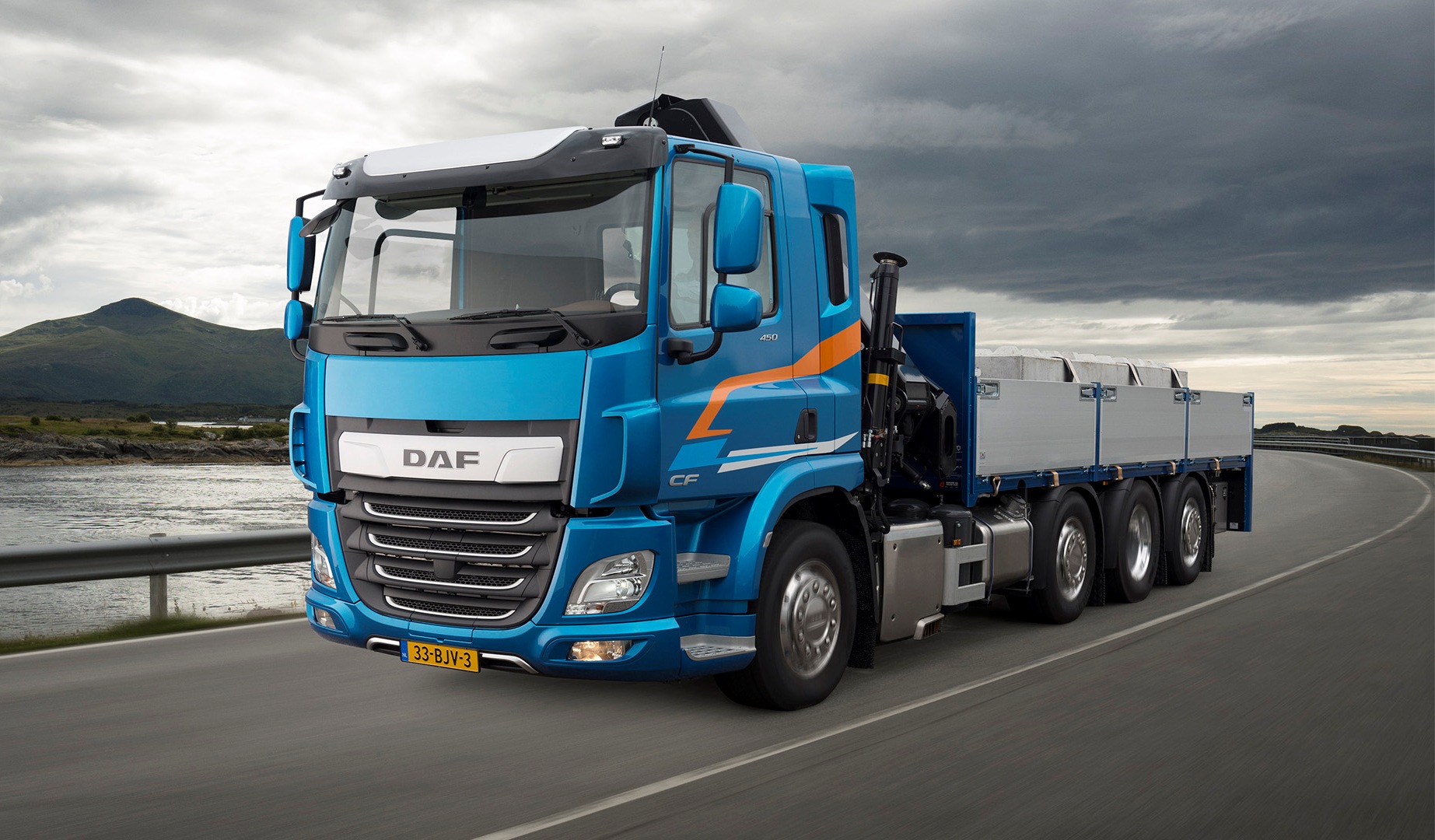

The lightweight CF FAD 8x4 mixer chassis is now available with a 19-ton single reduction (SR1132T) tandem and two 7.1 ton front axles. This cost effective high performing chassis which is popular in the United Kingdom is now available throughout Europe. As a result of the optimization of the steering system and the suspension, the use of disc brakes and the new compact EAS unit with vertical tail pipe, the curb weight of this lightweight truck is a mere 9,150 kg, which sets the benchmark for its class. The unique mixer chassis comes with the new PACCAR MX-11 engine, in power ratings from 270 to 330 kW (370 to 450 hp).
Highest body builder friendliness for New CF and XF rigids
DAF has introduced important enhancements to the chassis for industry-leading body builder friendliness. The new Body Attachment Modules (BAM) play an important role in the speedy fitting of a box body, a heavy crane, tipper or hook lift system.
The new and extended hole pattern in the rear-end of the chassis facilitates easy fitment of tail lifts, cranes and boxed bodies and also makes it easy to relocate components or mount a draw bar installation or underrun protection. As a result, the new hole pattern saves body builder costs while shortening vehicle lead-times.
