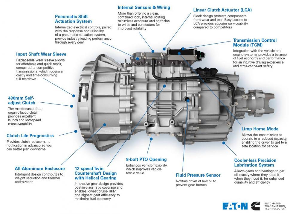

Features of the new Endurant AMT include:
  • A “wet weight” of 675 lbs., making it one of the lightest AMTs on the market;
  • The ability to handle loads of 110,000 lbs. and engine power up to 510 hp and 1,850 ft.-lbs. of torque
  • An internal electrical system routing that minimizes exposure and corrosion to wires and connectors for improved reliability;
  • A new smart prognostics feature provides clutch replacement notification to better plan maintenance scheduling;
  • A transmission fluid pressure sensor notifies drivers of low oil levels to provide “burn-up” warranty coverage;
  • A “B10” life of 1.2 million miles;
  • Predictive shifting using look-ahead technology to execute shift decisions that improve fuel efficiency and provide additional driver comfort;
  • A standard 8-bolt PTO opening that Eaton Cummins said helps “enhance resales value” the company said;
  • A 750,000-mile lube change interval for linehaul applications, which helps reduce downtime and maintenance costs;
  • A maintenance-free 430mm self-adjust clutch that requires no grease;
  • Only 16 pints of oil are needed for the Endurant, or about half the amount of competitive models, the company noted;
  • A replaceable input shaft sleeve allows for affordable and quick repair without a full teardown;
  • The standard Endurant transmission warranty is five years/750,000 miles for linehaul commercial vehicles, and three years/350,000 miles for the clutch. One-year and two-year extended protection plans are also available, the company said.

Features include:
  • Internal electrical system routing that minimizes exposure and corrosion to wires and connectors for improved reliability;
  • An industry-exclusive transmission fluid pressure sensor notifies drivers of low oil levels to provide burn-up warranty coverage;
  • Smooth and intuitive shift strategies that enhance the operator’s driving experience;
  • A standard, 8-bolt PTO opening that improves future resale value.All-aluminum exterior
Production will begin Oct. 16. Endurant will be paired with the Cummins X15 Efficiency Series engine and will be available in the Kenworth T680 and the Peterbilt Model 579.
“With the lowest cruise rpm among competitive automated transmissions and the best overall ratios, Endurant is ideally engineered to fully support the growing move to downspeeding to help save fuel,” added DeVito. “Among linehaul transmissions, Endurant has the deepest reverse ratio in the industry for slow speed maneuvering.”
Features designed to improve maintenance include:
  • 750,000-mile lube change intervals for linehaul applications, which company officials say is the industry’s longest and 250,000 to 450,000 miles longer than competitive models
  • Endurant requires only 16 pints of oil, about half the amount of competitive models;
  • A replaceable input shaft sleeve allows for affordable and quick repair, while competitive transmissions require a costly and time-consuming full teardown.
In addition, innovations such as a transmission fluid pressure sensor and clutch life prognostics maximize uptime.

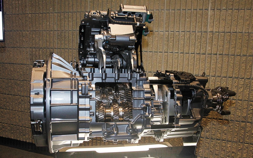

For example, the clutch actuator on the new transmission was relocated to provide easier service, on the advice of technicians.
To service a clutch actuator in its traditional location means removing the transmission, which is a five-hour job, he said, “versus taking half an hour to unbolt the clutch actuator [from Endurant] and slide a new one on.”

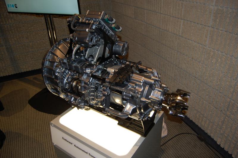

Endurant, the lightest heavy duty automatic on the market by 105 pounds, features an internal electrical system routing that minimizes exposure and corrosion to wires and connectors for improved reliability.
“There’s really very little hanging on the outside of the transmission,” says Gerard DeVito, vice president, Technology, Eaton Vehicle Group. “You can change the clutch actuator without taking the transmission out of the vehicle. That saves you about $5,000 on your repair bill.”
A new prognostics feature provides clutch replacement notification to better plan maintenance scheduling. An industry-exclusive transmission fluid pressure sensor notifies drivers of low oil levels to provide burn-up warranty coverage. Smooth and intuitive shift strategies that enhance the operator’s driving experience. Predictive shifting using look-ahead technology to execute shift decisions that improve fuel efficiency and provide additional driver comfort and a standard, eight-bolt PTO opening for resale value improvement.
Endurant also employs a pneumatic clutch actuator.
“As long as you keep it clean, you get a lot of force at very little cost,” DeVito says.
