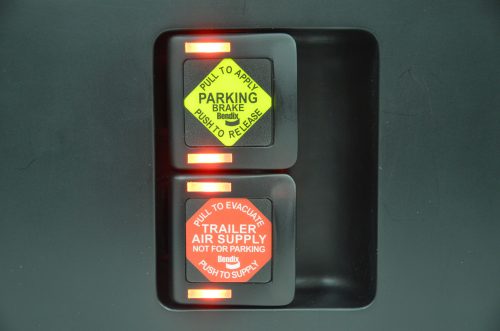

The Intellipark system is an electronic parking brake that automatically engages truck and trailer air brakes if a driver forgets to and exits the vehicle, leaving the truck vulnerable to rollaways. Bendix says 60 percent of fleets surveyed in a Frost & Sullivan survey said they had experienced a rollaway incident within the previous two years. Intellipark works through interlocks installed in critical areas, such as the seat, seat belt, or cab door – engaging the brake if the driver leaves the seat or opens the door without setting it first.
In addition to rollaway prevention, the system makes it easier for drivers to engage air brakes manually, Bendix says, replacing the push-and-pull switches with more ergonomic switches. The company did not say when the system would be available, but that it would provide updates at a later date.

Bendix showed a new feature intended to automatically prevent rollaway called Intellipark. The automatic braking technology replaces the manual air parking brake with electronic switches that will automatically set the parking brake if the driver exits the vehicle without setting the parking brake.
With sensors that monitor the driver seat, seat belt, or cab door, the system will detect if a driver leaves the vehicle without engaging the parking brake and will automatically set it to prevent a dangerous or costly vehicle rollback.
