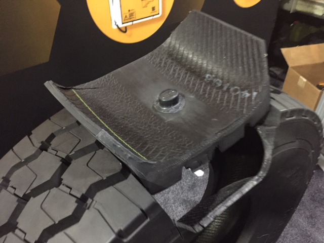

Sensors installed in the inner lining of the tire measure tire temperature and inflation. Mounting the sensors in the tire rather than on the rim helps prevent false readings due to heat being generated by the truck’s braking system, Williams said. The system does not require a telematics system on the truck, he noted.

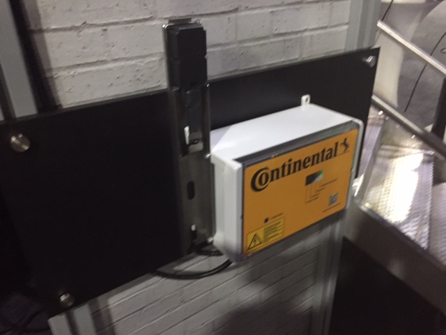

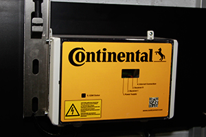

As trucks enter a fleet yard, terminal or other location where the company’s “yard reader” data station is installed, the station picks up readings from the sensors and transmits them to the ContiConnect web portal via a cellular network. The data from there can be read by a maintenance manager or other company representative, who can take corrective action that might prevent a tire failure on the road, Williams said.

During a press conference at the recent North American Commercial Vehicle (NACV) show, Continental explained that tire data is collected via a round battery-powered sensor glued on the inner liner of the tire.
As trucks enter a fleet’s yard, a “reader station” then picks up data from the sensors and transmits it to the ContiConnect web portal via a cellular network. Via that portal, fleet managers and other maintenance personnel can track low pressure alerts, high tire temperatures, as well as track data over time, Continental said.
The supplier said those sensors can be factory-installed on new tires or retrofitted to existing ones. They are mounted within the liner to more accurately detect the tire temperature and pressure without being influenced by heat from braking systems, Continental added.

The company added that the “reader station,” which collects and transmits the tire sensor data, needs to be within 65 ft. of a truck or trailer to accurately collect that information. Usually, the best spot is near a refueling island, Continental’s experts said.
