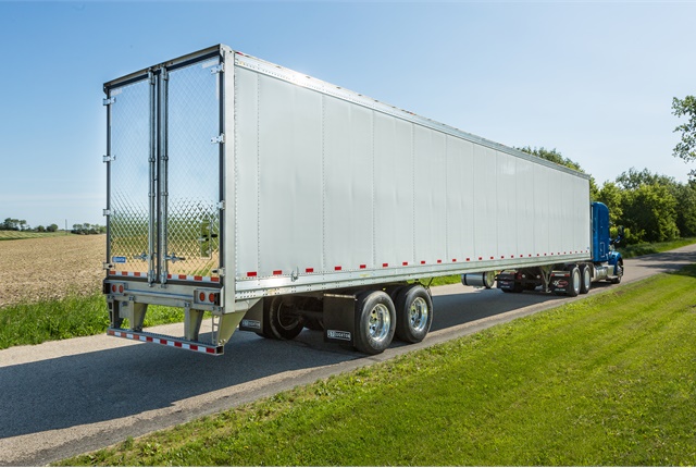

The PureBlue is the result of two years of development, and has features that Stoughton said sets it apart in the marketplace. They include a triple wiper seal door gasket designed to prevent water intrusion and minimize air loss, and platen foamed sides and roof to ensure that the trailer is fully insulated 360 degrees to prevent voids or uneven areas to further increase thermal efficiency, it said. Bonded side posts reduce the number of holes in the sidewalls to further aid in preventing moisture intrusion, and can improve the surface for installing trailer graphics.
The trailer also features an aluminum scuff and integral composite scuff liner to help prevent damage during loading and unloading, the company said.

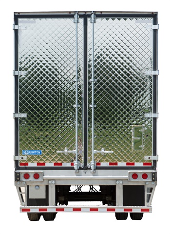

  • The composite rear door is built with a triple wiper seal gasket to prevent water intrusion and minimize air loss to protect the interior of the trailer and cargo from the elements.

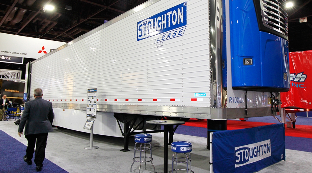

The platen foamed sides and roof ensure that the trailer is fully insulated in 360 degrees with no voids or uneven areas to further increase its thermal efficiency. In addition, Stoughton designed a composite mounting box for the refrigeration unit to help keep the heat of the reefer’s diesel engine from penetrating into the trailer.
Stoughton’s composite rear door design optimizes thermal efficiency plus it reduces weight, providing a lightweight, strong, thermally efficient rear door. The bonded side posts in the new refrigerated trailer reduce the number of holes in the sidewalls to further aid in preventing moisture intrusion, in addition to offering a smooth side ideal for graphic applications.
