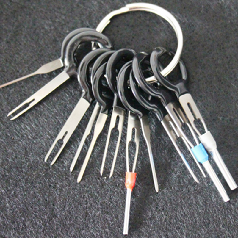

I went to Napa and got this Weather Pack, Pack-Con  terminal removal tool set. Ran as I remember about $12.00  It was made by Lisle
It's been awhile since I removed a pin and I don't have those connectors in front of me, but I'm pretty sure you slide the tool in the small portion of the hole, then lightly pry up towards the large part of the hole while lightly tugging on the wire from the back.  Once you find the "sweet spot" they will be very easy to remove.  The Weather Pack barrel pins, slide the tool over the pin as you put a small bit of pressure on the back of the pin. Push the tool in and wiggle the pin out. Like I said it's been a while. Some of the older terminals have a small plastic "wedge" to lock the terminal into connector.
