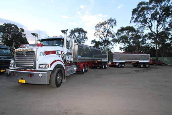

From a fleet that previously numbered around 14 vehicles, by 2014 Ken had downsized to just 4 rigid tippers and dog trailers, all that was needed to satisfy a local coal contract.
“The ever-changing demands of the industry today has seen the fleet expand once again, growing to 22 trucks and trailers, but with the emphasis moving from rigid tippers and quad-dog trailers to tandem A-double combinations. We also have more units currently on order and awaiting delivery.

“In terms of payload under PBS legislation with rigid trucks and quad-dog trailers, we can achieve payloads of 39.5 tonnes on a quad, 43.5 tonnes on a five-axle and 51.5 tonnes on the tandem A-doubles. Everything has BPW axles, BPW disc brakes, Wabco EBS with the Smartboard and we use Edbro hoists,” said Ken.

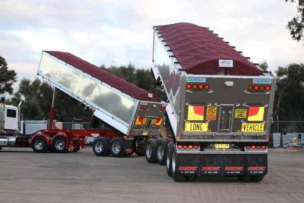

Commenting on the specification of the A-Doubles for Kim Haulage, Ben Weckwerth of Sloanebuilt Trailers said:
“Both of the Kim Haulage A-doubles are under 26 metres in length, the A-trailer being 86,550 mm long with the B-trailer being one of Ken’s existing PBS-compliant quad-dog trailers at 11,850 mm, all featuring side heights of 5’6”,” said Ben.
“All of the Kim Haulage Sloanebuilt dog trailer fleet can be operated as the back trailer in this combination, as Kim Haulage has a full PBS fleet of trailers with all trailers having been added to the vehicle approval.

“We speed limit trucks when the pto is engaged to 25 km/h, and we have blindspot cameras and hoist alerts with visual and audio alerts when the hoist is in the air,” said Ken McClelland.
“The camera vision covers any possible blindspot, and individual cameras are mounted on the top of the left-hand air intake and behind the truck body and the rear of the trailer,” said Ken.
