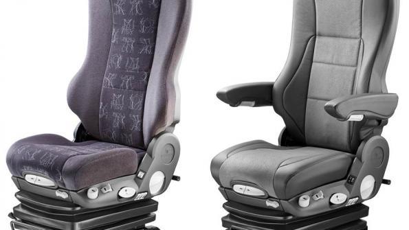

Seat manufacturer Grammer offers its Kingman High Performance driver seat with Active Seat Climate Control as “Kingman  Climate” for retrofitting. It is operated using three controls: a switch with two air settings, another for selecting either of two heating levels, and an off button. The system ensures a pleasant sitting climate at all temperatures, according to Grammer, in the summer and the winter.
Active Seat Climate Control from Grammer takes advantage of activated charcoal: perspiration that accumulates where the body contacts the seat is removed via the cover material and temporarily stored in a layer of activated charcoal underneath. This keeps the seat’s surfaces pleasantly dry, even in the hottest weather, Grammer claims.
In contrast to conventional seat climatization systems, which achieve a cooling effect by directly blowing air onto the body, the Grammer system supports the natural cooling function of human skin. This avoids the health risks of inducing a draft, the manufacturer says, because body moisture is constantly and gently removed.
Beneath the layer of activated charcoal, there is a ventilation layer through which cool, dry air flows. This level removes moisture from the activated charcoal. As a result, the seat’s occupant experiences a pleasant temperature at all times, with a dry back and buttocks.
After the seat is vacated, the activated charcoal automatically discharges its moisture load. Compared to a seat without climate control, the differences are substantial: the seat’s surface temperature is about 10 percent lower on average and relative humidity is some 20 percent less, according to Grammer's studies.
