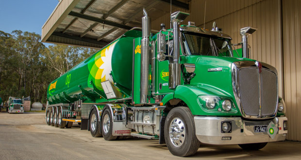

Simpson Fuel Supplies located at Oakville in Sydney’s west, has just recently commissioned into their fleet the first of its quad-axle PBS single tankers.

Adding to the overall versatility, the new quad-axle tanker comes in at a total length of 17.98 m when coupled to Simpson’s Kenworth T409, enabling the reduced weight of the total combination to run on general access routes when required.

The end product results in a 48,600-litre maximum capacity, six compartment, quad-axle road tanker, featuring Hendrickson INTRAAX axles, a push steerable rear axle, with drum brakes throughout on Alcoa alloy rims.
ABS, multi-volt TEBS (trailer electronic braking system), and rollover stability as per PBS requirements are utilised complying with ADR 38. Braking and suspension functions are controlled and monitored by the WABCO smartboard, a centrally-located multi-function control panel, with all functions easily accessed by a single click, to monitor axle weights, suspension height, odometer and diagnostic functions.
The six individual compartments have SFLs from one to six of 8210 litres, 8210 litres, 8200 litres, 7100 litres 7130 litres and 8210 litres, with the maximum of three loading arms loading at any one time in most terminals, and a full load of diesel being loaded at rates of 2200 litres/minute. Drive-in/drive-out load times of 35-40 min could be achieved, a definite advantage over a B-double that must be disconnected and reconnected for each trailer and a seventh compartment to load.
