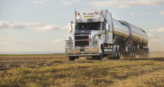

The fleet today comprises seven Freightliner Coronado 114s – all powered by Detroit DD15 engines with Eaton Roadranger manual transmissions and hauling 25-metre B-double aluminium fuel tankers, supplied by Holmwood Highgate of Brisbane.

All the Coronados operate in B-double configuration and are pretty much identical, with each carrying a capacity of 54,000-54,500 litres of diesel. The majority of the loads are distillate as MAKTRANS predominantly specialises in the longer distance rural work that local distribution companies find difficult to fit into standard daily transport work programmes. Normal scheduling includes the distribution of fuel out of Brisbane and Newcastle, and as far west as towns such as Walgett in NSW and Cunnamulla in South West Queensland.
