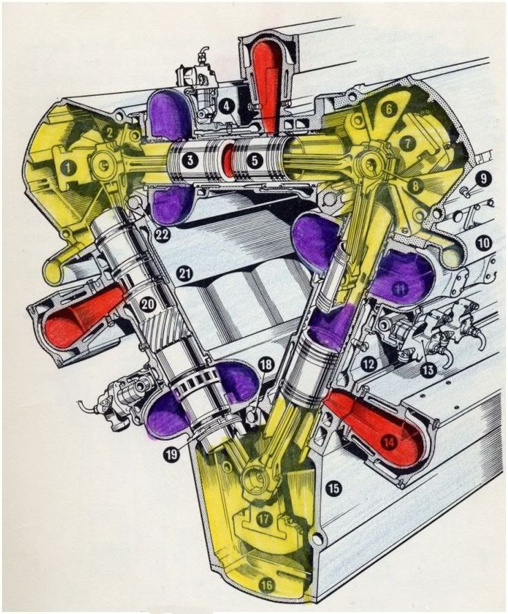

                     A discussion came up at work about odd engines and I tried to explain the Deltic and ended up using this cutaway pic which did a much better job.

Looks very cool. Probably way ahead of its time, but gives me a headache just looking at it! LOL

In the cut away pic above the number 19 there is a bunch of square openings. Are they part of the cylinder? If so does that mean it’s a 2 stroke?
Yup, 2 stroke 18 cylinder
