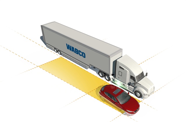

The first is OnSide, a radar-based blind spot detection system for commercial trucks and trailers – a system WABCO said provides a 160-degree field of view and coverage for up to 65% of a standard 53-foot trailer.
It alerts drivers to the potential of a side collision with a vehicle traveling in a truck’s “blind spot,” the company said; an area in the adjacent lane which drivers cannot see in rearview or side view mirrors.
The system uses advanced short range radar to detect a moving vehicle in the blind spot – especially in “low visibility” conditions such as darkness, rain, snow or fog – and then alerts the driver with a visual signal.
WABCO noted that when the truck’s turn signal is engaged, the system provides a more assertive warning in the form of an audible signal or a seat vibration.
Mounted out of sight behind fairings on either side of the vehicle, OnSide’s “plug-and-play” functionality does not require alignment or calibration.  It is also designed to provide alerts for only “moving” targets, not objects that are stationery, the company stressed.
When used in conjunction with WABCO’s OnLaneASSIST lane keeping assist system, OnSide can provide active collision avoidance, the company said – with OnLaneASSIT applying a correction torque to the steering wheel to return the vehicle towards the lane center.

OnSide helps improve commercial vehicle safety by alerting drivers to a potential side collision with a vehicle in a truck’s blind spot. The system uses advanced short-range radar for vehicle detection and then alerts the driver with a visual signal. When the truck’s turn signal is engaged, the system provides a more assertive warning in the form of an audible signal or a seat vibration.
When used with Wabco’s OnLaneAssist lane-keeping assistance system, OnSide can automatically return the vehicle to the lane's center. If a lane change is initiated and OnSide detects a vehicle in the blind spot, OnLaneAssist applies a correction torque to the steering wheel to avoid the collision.
Wabco OnSide’s radar sensor enables a 160-degree field of view and provides coverage for up to 65% of a standard 53-foot trailer. The system performs reliably even in low visibility conditions, such as darkness, fog, rain or snow, according to Wabco.
OnSide can distinguish moving vehicles from objects that do not pose a hazard to minimize false warnings. The system can be mounted out of sight behind fairings on either side of the vehicle and features plug-and-play functionality that does not require alignment or calibration.
