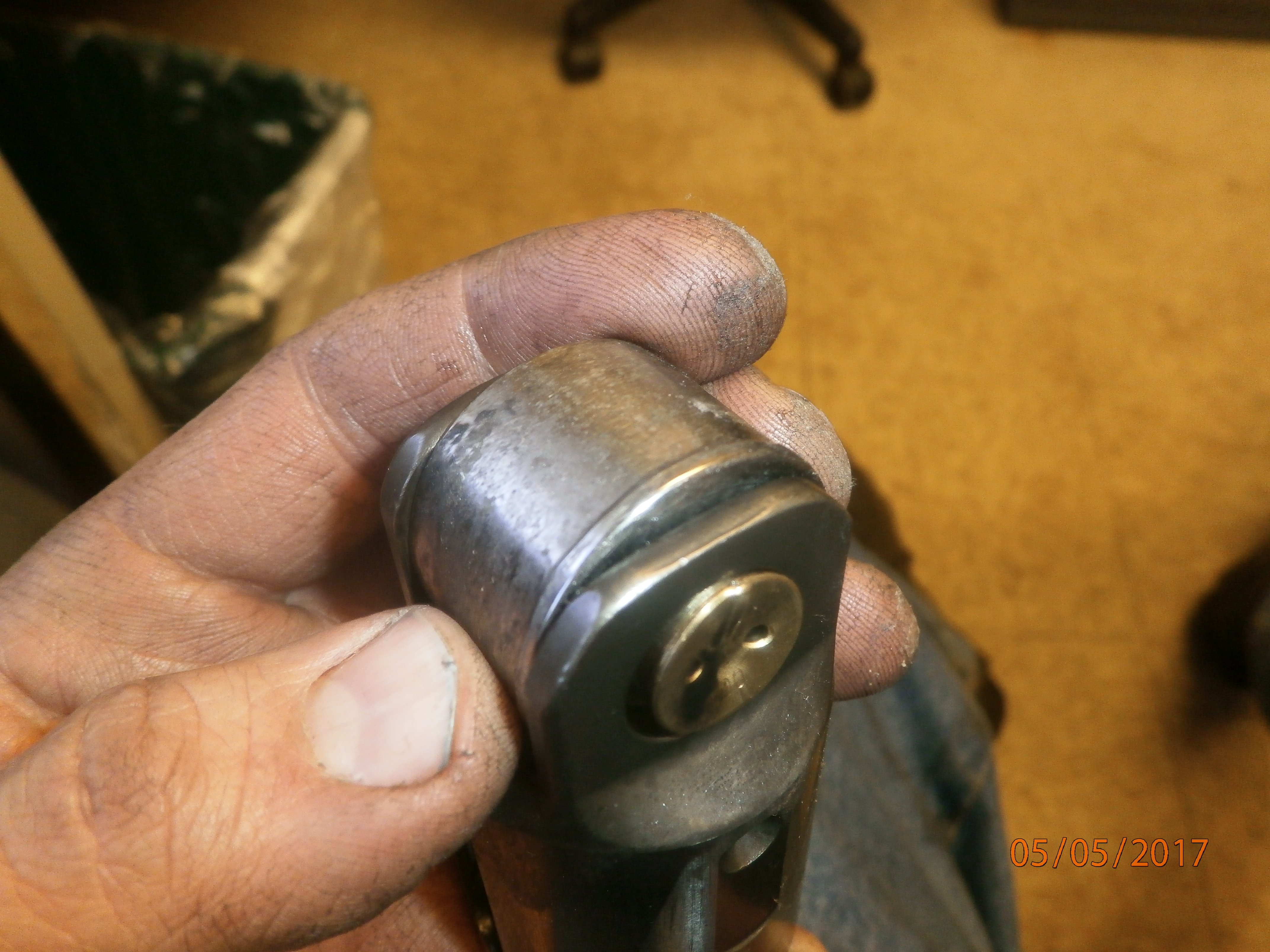

You can ohm it to a know-good EUP. You can continuity the lines back to the ECM (or firewall) if your up to a light amount of digging.
I'd get a PAI (especially if you have no miss, still running, and can order "aftermarket") to replace only the bad unit. Pretty easy day on a truck like yours!
Pull the block fitting and drain the block before you pull it, or dump into sump and just change oil.
Roll engine to get the EUP cam lobe down to make install easier, pull bolts up equally when loading back into block.
Always replace both retaining screws.
Record EUP calibration code (on front plate) so you can have code uploaded next time your in the shop.
Gently remove EUP roller and inspect. Scissor spread your fingers (or insert a hook pick into roller slot) and gently lower back onto cam lobe without dropping.
Check guide indexing pin in wall of EUP bore.

https://www.bigmacktrucks.com/topic/51514-unit-pump/#findComment-383498
i didnt even know it was a problem until the light came on. truck still runs fine.
do you have a link or part number for the PAI unit?

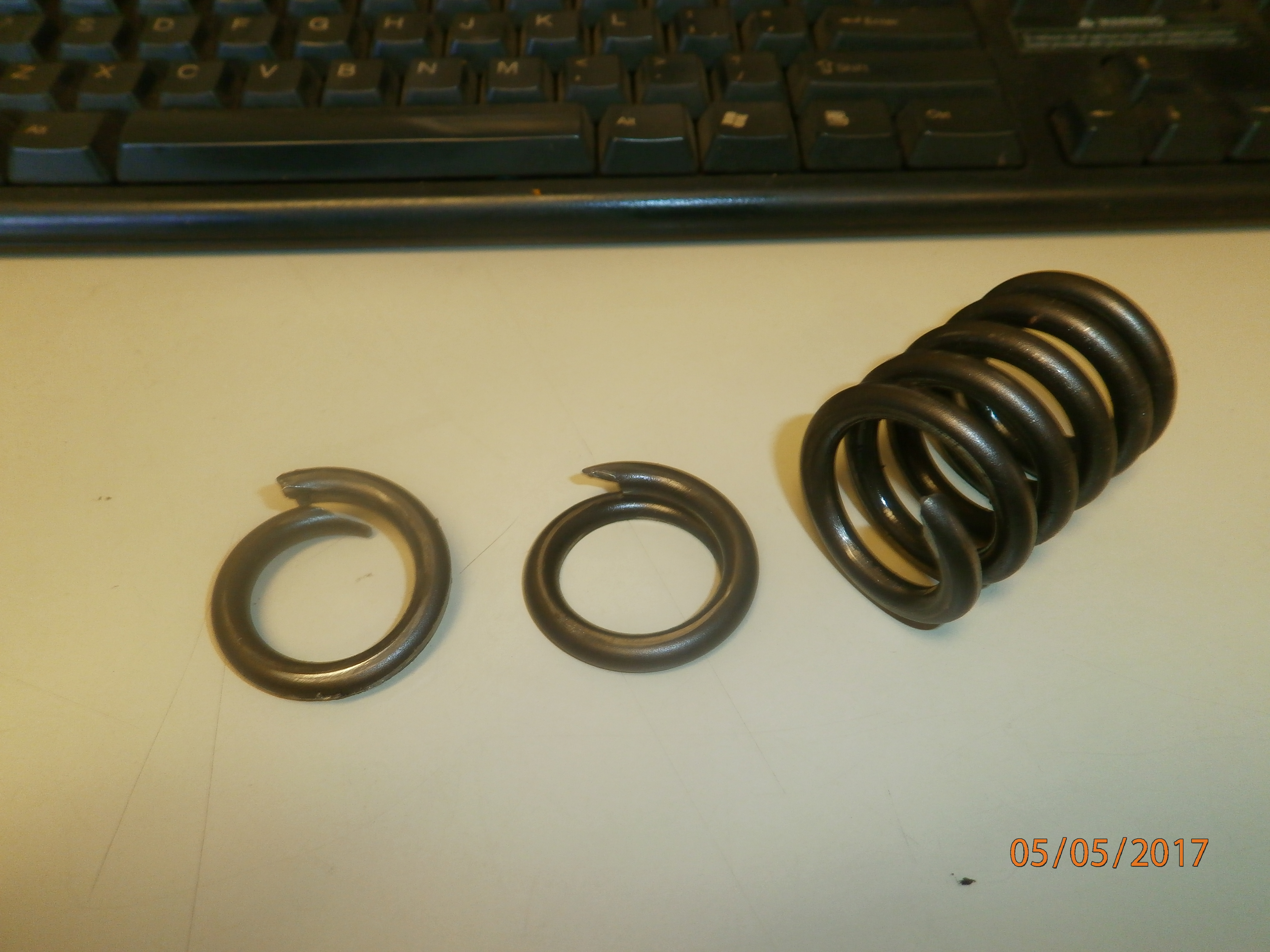

https://www.bigmacktrucks.com/topic/51514-unit-pump/#findComment-384028
I'll give that a shot.
Well didn't think of that. I know mine have never been touched so that very well might be a problem. I wanted to inspect them. Man let me tell ya. Those eup have become more of a headache then anything on this truck lol no matter which way I go there is always something lol but luckily the light have never cam back on since then but I would really like to get my eyes on them to see the condition of the insides and put new orings and whatnot.
