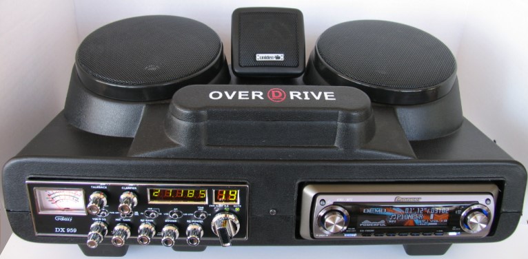

The CB in my R when I got had whats called a Slip Seat Radio box. Housed a CB and Stereo radio with two speakers. Slid into a bracket between the seats with power, just needed to plug in antenna leads  It was removable to go from truck to truck. sold through Overdrive magazine a few years ago..  You could probably make up a similar one.

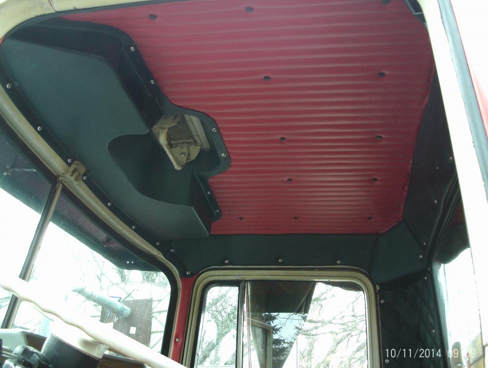

A later style American R-model headliner console has relatively complicated shape to be reproduced of sheet metal. I'm going to keep it original of its form using SS inserts glued up to the inner surface to reinforse the plasic body. With edges bent with holes drilled to attach the whole part screwing it to the cab through metal parts also. Those consoles used to start cracing from the mounting screw holes. Then after the "shaping work" is complete I'll bring it to upholstery guy to skin it up at the outside. So CB installing question should be resolved before the final step.
The one at the picture is not mine but a nice work of one of our members.
Paul, this solution won't work for me since I have a walk-in sleeper behind the cab. But the idea worth attention no doubt.

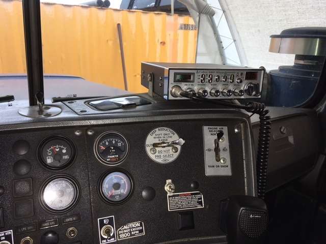

Does your mic attach to the side or out the front of the cb ?   I had mine mounted on top the dash ( covers part of the ash tray) and it worked ok, but if i were to do it again i would put it above, in front of the passenger.

Vlad, my favourite spot is on the dash by the ash tray. Its easy to mount and easy to use there.

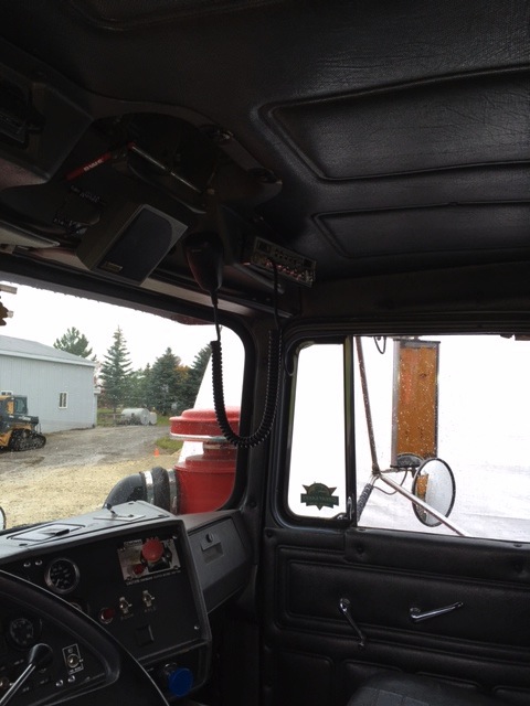

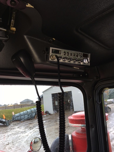

My 1988 R has it mounted in the overhead console. It looks really good and is tidy. But its not as handy to access controls though. But it is certainly manageable.

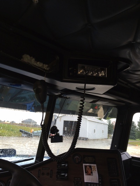

My off breed truck has it overhead as well. in the centre. the mic cord hangs down in front of me . but it doesn't bother me at all. its nice and handy.
I have added pics for you. Maybe it helps a little .

Thank you for these detailed pictures. They show out things very actual. Just want you to know - did you put the CB in the hole above the passenger seat a bit biased just to have better access to the controls? I mean I hope the reason was NOT because of the space short to clear all the length of the unit.
Of what I see in the pics the best location is the off-brand truck with special CB slot in the center of the console. But don't plan to go off-Macking so continue figuring the matter out.
Vlad, the previous owner put the CB above the passenger seat. I had always figured it was turned a bit for a little easier access.
It could be possible though, it is because of room. I never thought of that . I have never had it out , so I can't answer you properly.

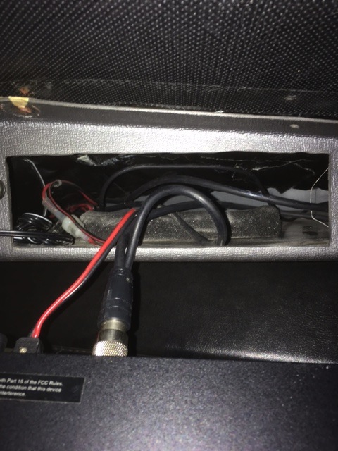

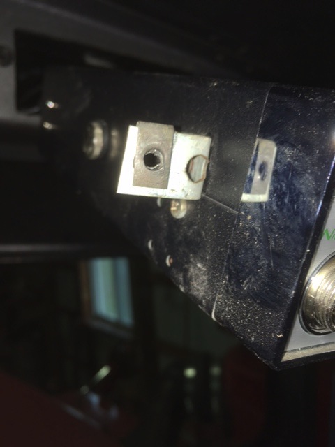

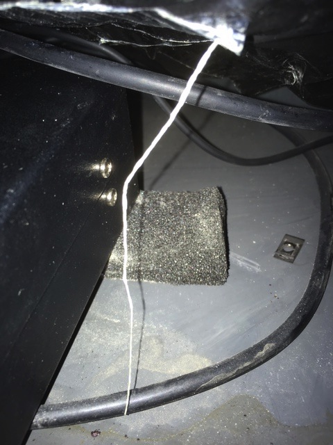

So after some investigation Vlad, I found the CB is mounted with 2 screws mounted to the front. Screwed into some home made brackets.
The CB is actually resting on some foam so there isn't much stress on the front.
I attached some pics to help.
As for the amount of room .  It fits no problem. You could even set it in a little farther if you want . Just a little though. Remember you need room for antenna and power wires .
Please keep us posted on your progress :thumb:

Keith, thank you so much for the investigation job. Today I made a bit of dancing with a measure bend and it seemed like there's place enought there indeed. But I wasn't 100% sure, there's insulation wool hanging there together with some wires and so on.
Mu current option is to buy another radio with a side mic connector, put it above the driver seat and extend the mic cable behind the console to a hole in the middle area I'll drill for. So the outside mic cable would hang from near the center of the wind screen and to the mic bracket somewhere at the right to the radio. And by the right driver's hand at the same time. There's another nuance though. Isn't there a speaker at the bottom of a Cobra CB? And can you hear from it when the unit is slid inside the console?
