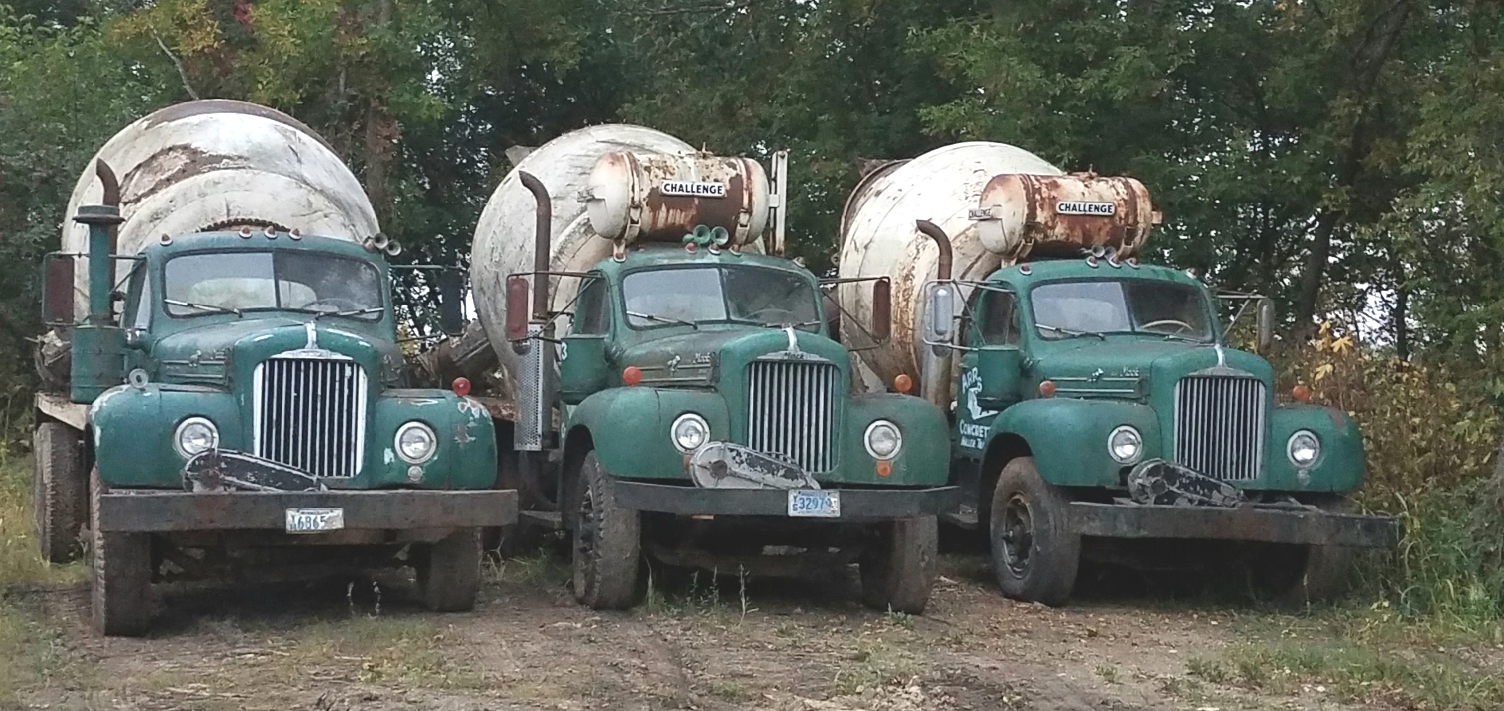

I'm trying to get a picture here of my truck (s) but must be too big. Will keep trying.  I found a treasure about 2 months ago. Been looking for a solid B61 for a couple years. Stumbled onto some trucks at a cement plant that sat since DOT rules evolved in '88 in Minn.  The trucks sat for 30 years. We literally cut them out of trees, winched them onto lowboy and hauled home. Five trucks. 3 with complete mixers,one gravel truck and one boom truck used for hauling blocks. Within 4 days had all of them running. One mixer and the gravel truck (1960's) detail numbers are in series. Will work on pic or PM me ( not sure if possible)and will send that way, Its been fun......
