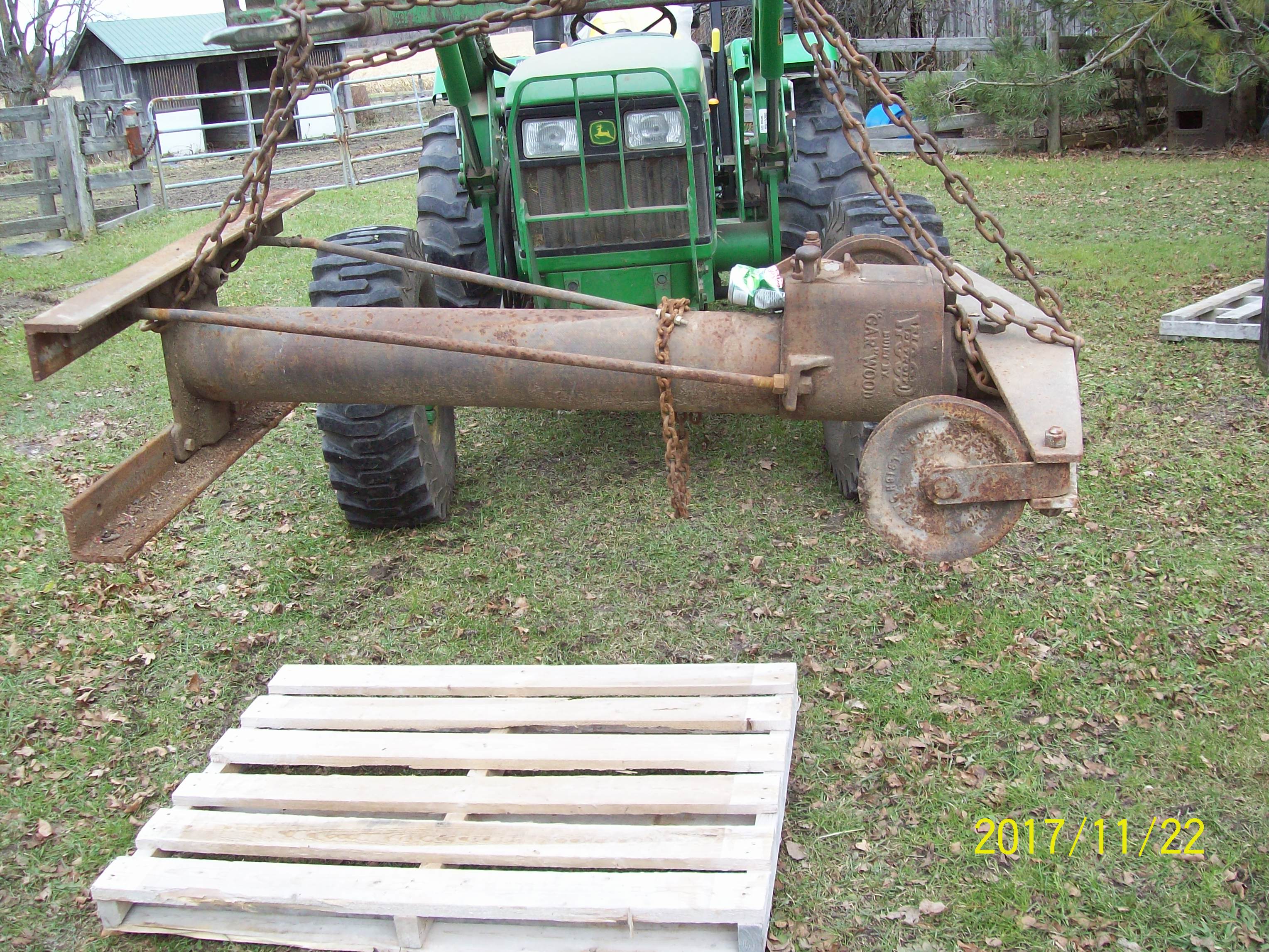

Not much progress on the AC but I have determined that the hoist cylinder is not stuck.   I have a 1920 Paige 2 1/2 ton with a Wood hoist & it has an odd looking pipe near the top that is much larger than the pipe to the pump.  Does anyone know if there is a check or something in that line or perhaps it was just a way of making the pipe fit?
I also have assembled all of the loose body parts & other than fenders I have good patterns for everything.
