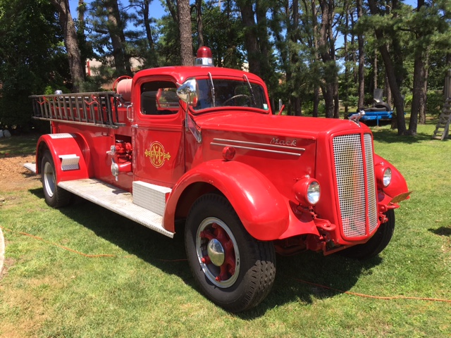

Nice rig!
Loosen the hose clamps and hoses.  Undo the fasteners for the front support rods between the rad. and the cowl.  Also loosen slightly the front hood hinge/strip bracket.  Close the hood but don't latch.  Remove the two large radiator nuts under the front crossmember.  Pull the top of the rad. forward to allow the center hood strip to slide out of the bracket.
With assistance, remove the hood and with some more help and a selection of cuss words, the radiator comes out as an assembly.  Removing the fasteners from between the radiator flange and grill will separate everything.
