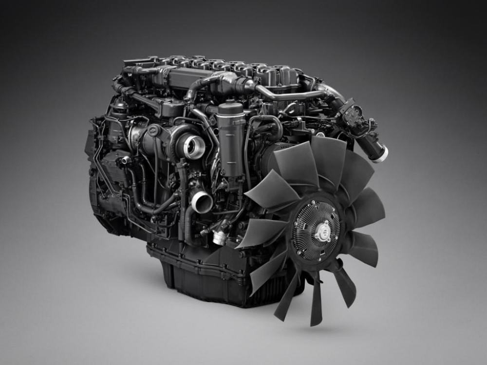

Scanias launch of the OC13 gas engine marks the start of alternative fuel solutions for the new truck generation. The OC13 is based on Scanias well-proven 13-litre engine. The engine works according to the Otto principle with spark plugs and complete combustion.

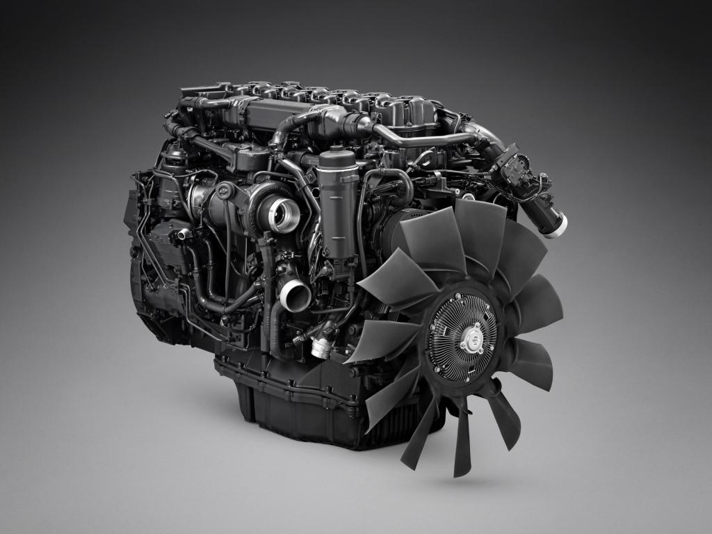

Technical data
OC13 101
Type
Inline
Cylinder capacity
12.7 litres
Firing sequence
1-5-3-6-2-4
Cylinders
6
Valves per cylinder
4
Bore x stroke
130 x 160 mm
Cam type
Normal
Compression
12.6:1
Fuel injection
Bosch
Emissions treatment
Scania EGR and 3-way catalytic converter
Oil volume
43 litres
Max power
410 hp (302 kW) @ 1,900 rpm
Max torque
2,000 Nm @ 1,100–1,400 rpm
