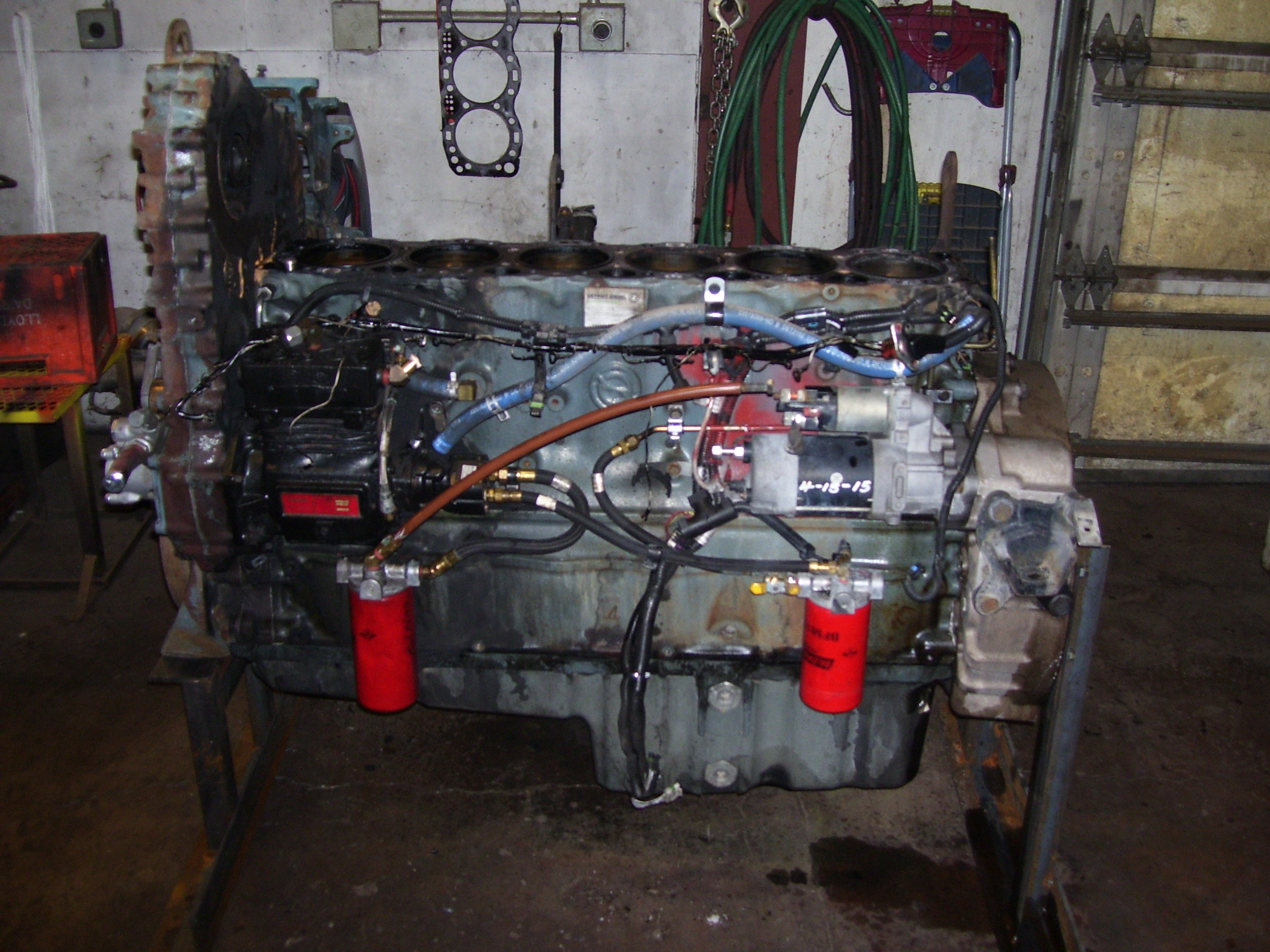

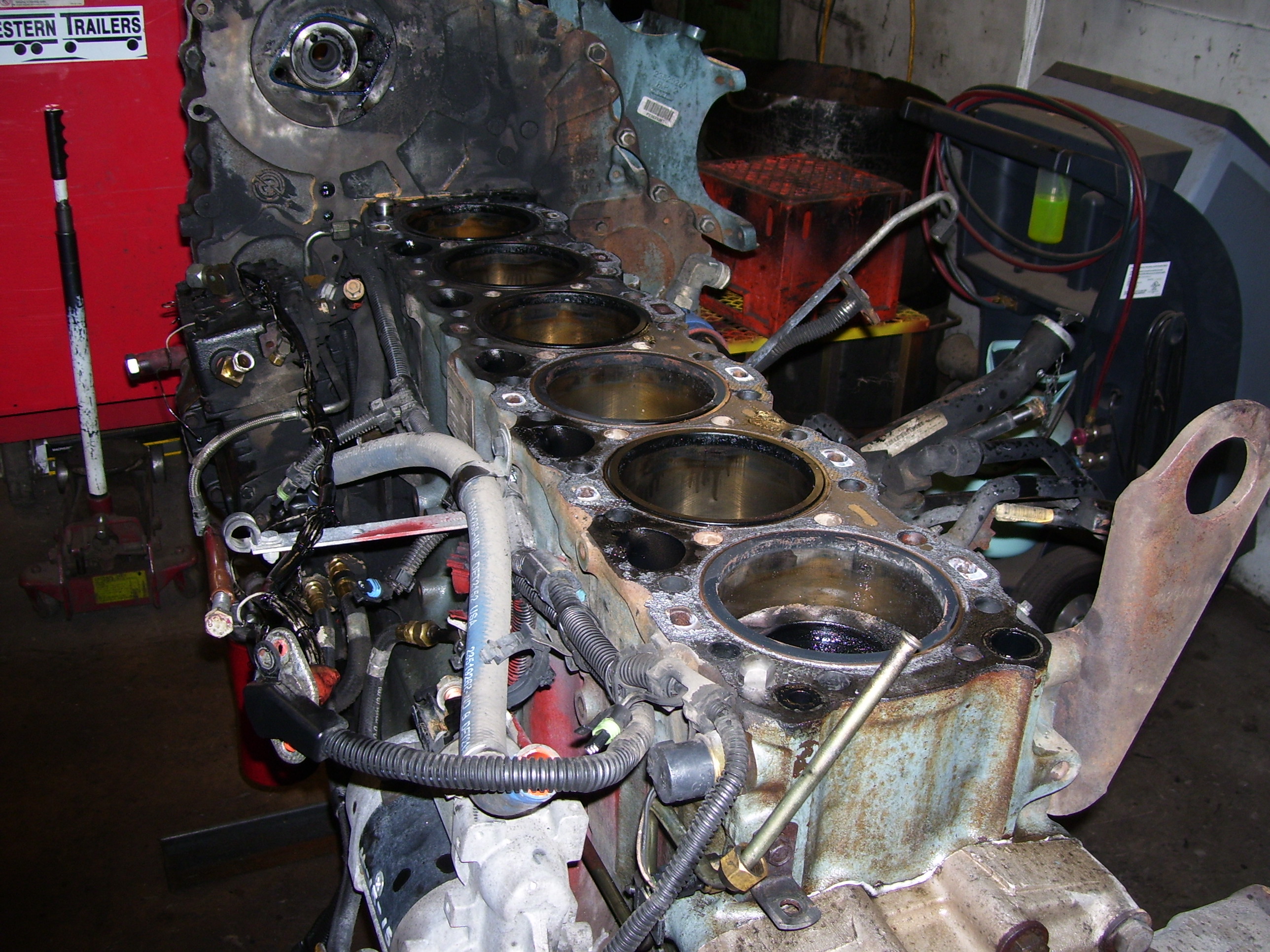

In 44 years of this work it's not my first rodeo. I own all the tools required to do a rebuild on Series 60's. We have 46 tractors and 17 of them are 14L 60 DDEC IV. The company had 20 DDEC V's
EGR models-junk. As soon as it lost compression it shut down. And yes it's getting new rods.

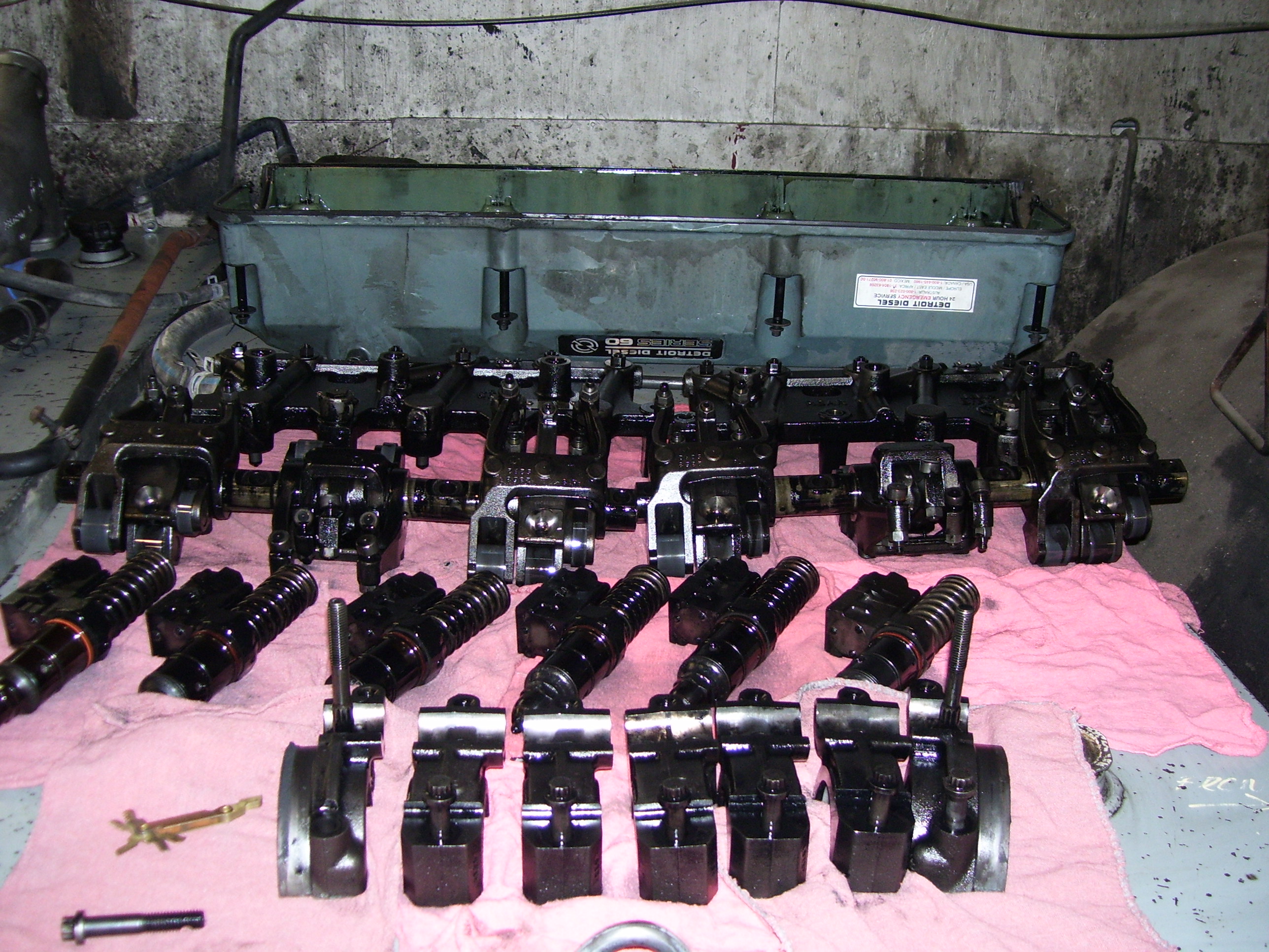

                                  It was a light Saturday for service work so I pulled the front structure apart and checked the gear train mainly the bull gear for end play and wear {ok}.
                                  So it was a clean and reseal. It's an easy job when out of the rails. When you have the chance it's always good to check the bull gear.
