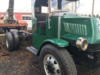

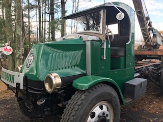

Very nice swap,  it was an AC-6 chassis originally.
Just curious, What would make you think that? I was under the impression that AC-6 had 13 louvers in the hood instead of 10 on a regular AC.
I agree.  The hood and therefore the frame is a bit longer on the AC6 models.  This truck looks like the 10 louver hood fits perfectly.  Was it modified?  Years ago I looked at buying several AC's in New Jersey that had been converted to modern 6 cylinder engines.  They used the original radiators and had done a pretty job with the conversion.  One of them was a tractor model with the rear spring hangers rolled down and smaller rear wheels to lower the chassis height.  I didn' t buy them, but I wonder what happened to them.  They were near Woodbridge, NJ.
I miss counted Sorry!  But one of my parts trucks is a 1920 with an 11 louver hood that was standard with the early radiator. The 11 louver hood was on my 1928-with the cage fan rad.
