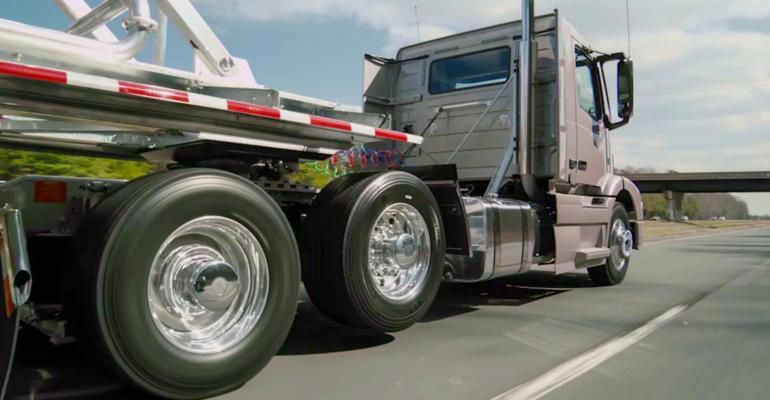

During the recent Run on Less fuel economy demonstration, Ploger’s Joel Morrow was driving a 2016 Volvo equipped with a 6x2 liftable axle. I talked to Joel recently to get his thoughts on 6x2 liftable axles. He told me that the time the axle was up exceeded his expectations, which resulted in more fuel savings than he thought he would see.  He also believes that the spinning inertia of components have a bigger influence on efficiency than most think – think about these liftable wheel ends just hanging there, or smaller parts spinning in lower displacement engines.
Another big savings came in the area of tires. When the axle is lifted, the tires are not on the ground so there’s no tread wear during those times.
Overall Joel is pleased with the performance of the liftable 6x2 and the additional fuel economy it gives him. While I know that liftable 6x2 axles aren’t right for all applications, you might want to take a look at them especially if you operate at less than 60,000 lb. GCWR at least 30% of the time.
