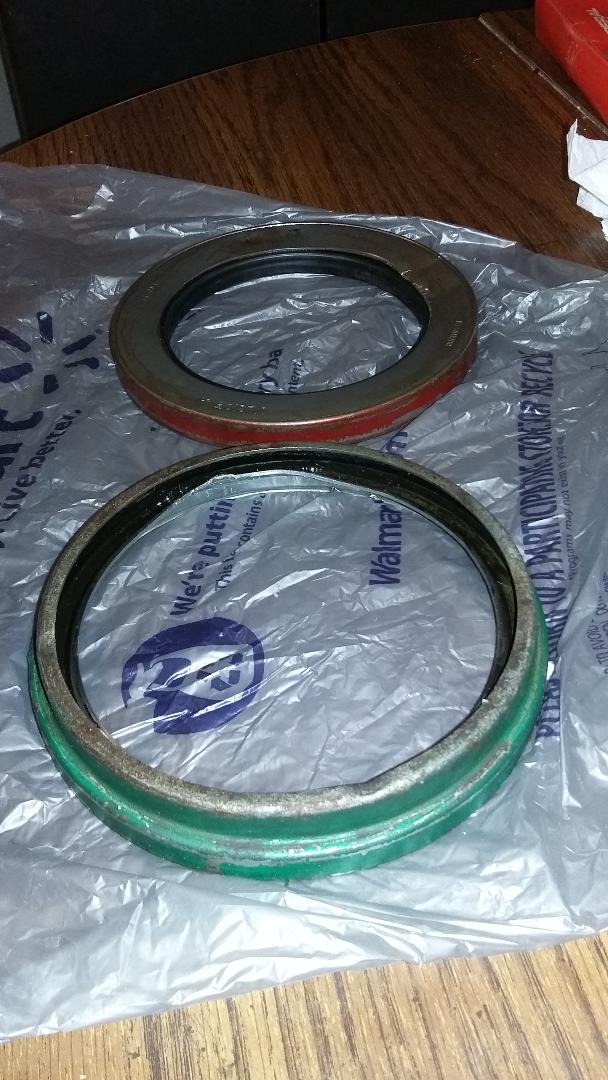

hello everyone, looking for some input on rear wheel bearing seal choices. i took everything apart this past weekend and much to my surprise the truck had to different seals. i was told by cooks brothers here in northeast pa. that both type seals would work just fine. i was just wondering if the green seal would be better in any way because it's taller? oh , and yes the seal section has been ripped out of the green one that's why the hole looks larger. secondly, what is the proper way to preload the bearings and the torque specs for the axle nuts for this set up? 1962 b67 single axle ......rad 512 rear .....4 1/8 axle nuts ....16.50 x 7 inch brakes. i appreciate any suggestions. thanks, tomvb.

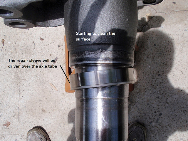

any ''wedding band'' rings on the axle? usually there are about a half dozen different seals that will work. all depends whats there. sometimes someone puts a 2 piece seal or wedding band on if something is worn on the axle tube
Tell tom or jeff you don't want the old style stemco's they will leak. Try a national seal they work real well if your seal surface is just a little worn . Look at the paperwork in the seal box it should tell you all you need to know how to preload bearings and torque on nuts.
When I was turning wrenches, we didn't use the specs. We would tighten down the first nut while slowly spinning the hub (to seat the bearings and races) and then back it off a little. Then turn it just until all the slack is gone. Then crank the locknut down with a 24" breaker bar, if you lean into it pretty good that's tight enough. In 18 years of putting wheels on, I never had one come back (and don't say that's because they went off the side of a hill).
I run and maintain a small fleet of 7 dumps, I only use stemco voyagers . Easy install and the turn inside its self design lasts longer than the traditional seal that rides on the spindle. But they do go for about $40 apiece . As far as torque , I've always cranked them down tight and backed them off, just like h67st said.

IMO either seal pictured is a good seal national and c/r are descent seals The stemco voyager seal is also a good seal !
 And I don't want to start a pissing match here however, IMO again, if your offered a stemco two piece turn and run! Over the years this seal went from my favorite to my most hated seal,  Now a days just an observation ,  if I find a leaking wheel seal on a unit  7 times out of 10 its a stemco two peice I Won't use one unless I'm Desperate !
Just An opinion!
I used a stemco 2 pc on my truck a few years ago.  All I could get my hands on in a pinch.  Still dry,   I've heard horror stories about them, but with the little mileage mine gets I hope it lasts my lifetime.

Been using stemco 2 piece grit guard for many years with no failures at all. I like the 2 piece because we run many old trucks with pitting on the seal surface all you need is the correct seal installer and good to go.  Just my opinion yours may vary
