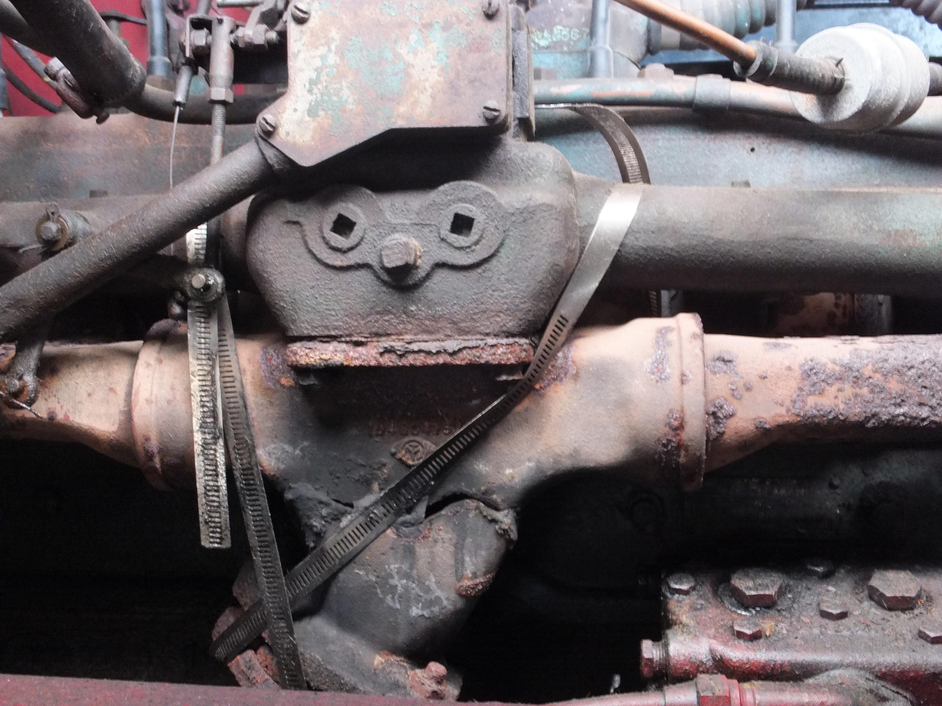

Kkergall - Yes, and I am assuming I will change the whole assembly.  104GC 439A (Rear) 104 GC 440A (Front) and 104 GC 4157 (Center).  That is, if it cannot be welded.

Sorry for the delay in getting back to you.  According to the book I have (Parts List 2342; for B42IT, for EN401 Engine) it has the same part numbers.  If it cannot be welded, I would be looking for one also.  Thank you.  I just started the truck the other day and it ran fine, so the Exhaust Manifold is the only thing holding it back.

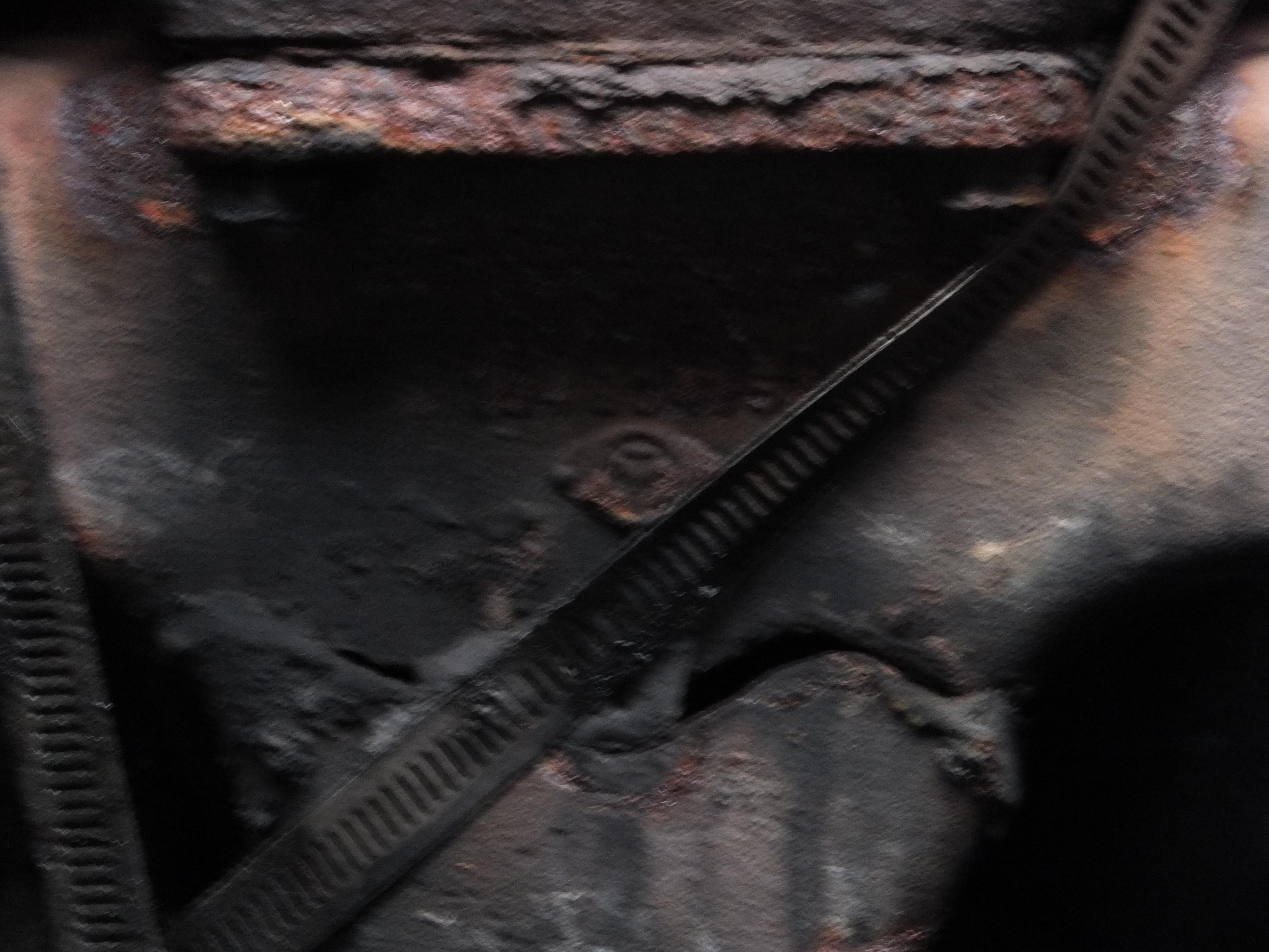

Would you post up a photo of your broken manifold? I'd like to see if I could repair it. My "spare" 401 engine does not have an exhaust manifold installed.
That I feel can be repaired. If you can do without the manifold a couple of weeks and want to send it to me I'd like to see it closer.

I agree, looks easily done with the clean fracture. Just a timely process.
