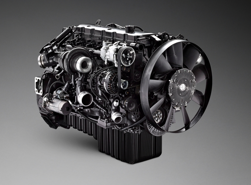

SCANIA’S 7-LITER ENGINES
  DC07 111
220 hp
DC07 112
250 hp
DC07 113
280 hp
Type Inline
Displacement 6.7 litres
Cylinders 6
Compression 17.1:1
Emission control Scania SCR
Exhaust brake 105 kW at 2,500 rpm
Max. output 220 hp (162 kW)
at 1,900 r/min
250 hp (184 kW)
at 1,900 r/min
280 hp (206 kW)
at 1,900 r/min
Max. torque 1,000 Nm at
1,050–1,500 r/min
1,100 Nm at
1,050–1,550 r/min
1,200 Nm at
1,050–1,600 r/min

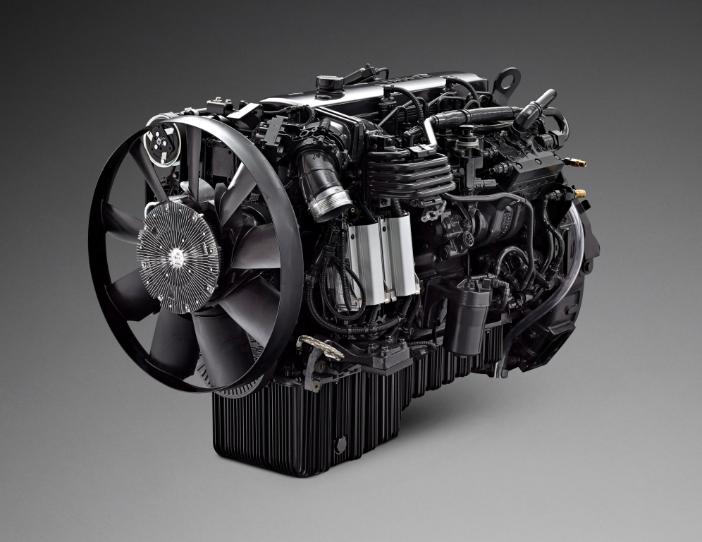

Scania has launched the DC07, a new 6.7-litre engine, which it claims will offer a 10% improvement in fuel economy over its 9-litre DC09.
The Cummins-built in-line 6-cylinder engine, which also features in the Daf LF as the Paccar PX-7 [Cummins ISB6.7, originally called PX-6], has been heavily reworked by Scania.
The new engine features a completely new fixed geometry turbocharger and Scania’s in-house exhaust gas after-treatment system, allowing it to tackle Euro-6 without the need for EGR.
The DC07 is offered in three power ratings (220hp, 250hp and 280hp), with torque ratings from 1,200Nm to 1,400Nm.
It is the smallest truck engine Scania has offered in decades, both in terms of displacement and physical dimensions.  It is 360kg lighter than the 5-cylinder DC09, and because of its size, results in a lower engine hump in the P-series cab.
Although available in trucks with GVWs as high as 26 tonnes, the DC07 is expected to prove a popular choice in lower weight vehicles.
