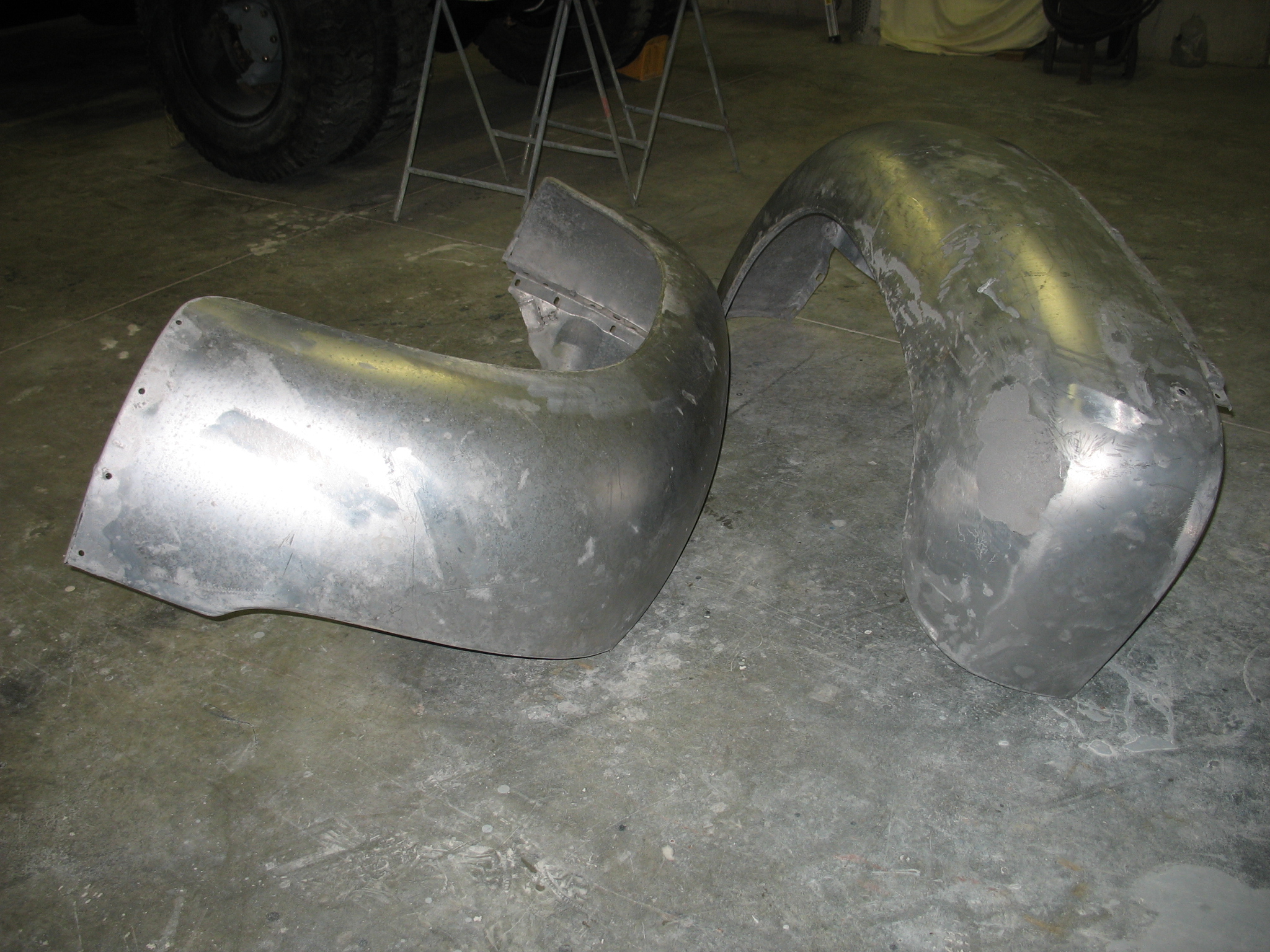

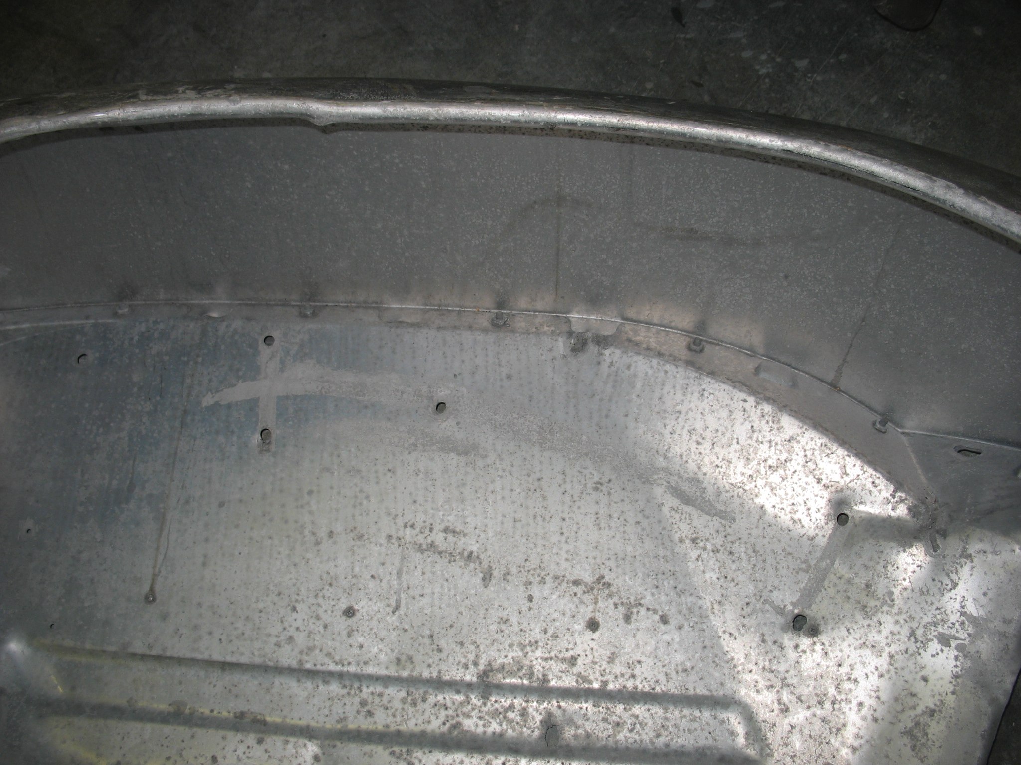

Dipped in a strong caustic similar to a paint stripper . Removes all the paint, grease, tar  and whatever.  Pressure washed then placed in strong electrolite solution.  Neg. D.C. voltage   is attached to the item and pos. to an anode in a large tank. He tells me as long as voltage is on the steel the only thing that is removed is the rust.  $250.00 for both fenders and inner fenders . When I picked up the fenders they were removing the body of a 1964 chev .  and a smaller car.  They do mostly industrial items.  Outside there was a lot of industrial items , a 1950 Lincoln ,and a small kids tricycle waiting to be done .

They can not do aluminum . There is hold harmless agreement on their invoice sheet that they are not responsible for any damage to aluminum.  Like Valadislav said you can do this yourself. I have done it in on a small scale in a plastic bucket with a battery charger, 12 volt battery, and vanish toilet bowl cleaner. My results are not as good as they do .
