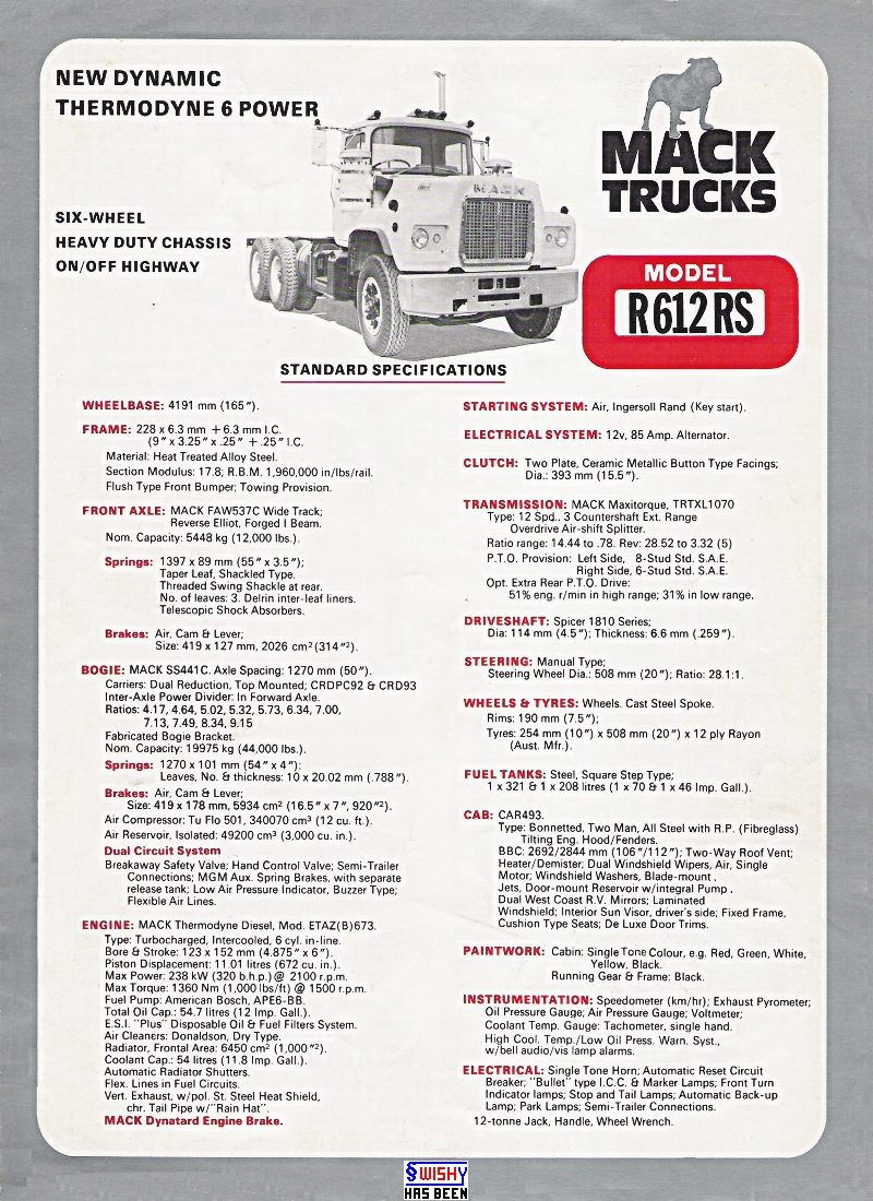

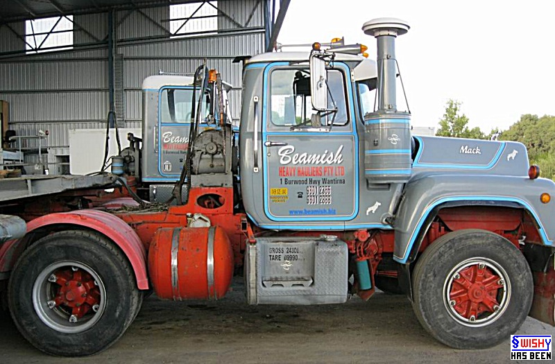

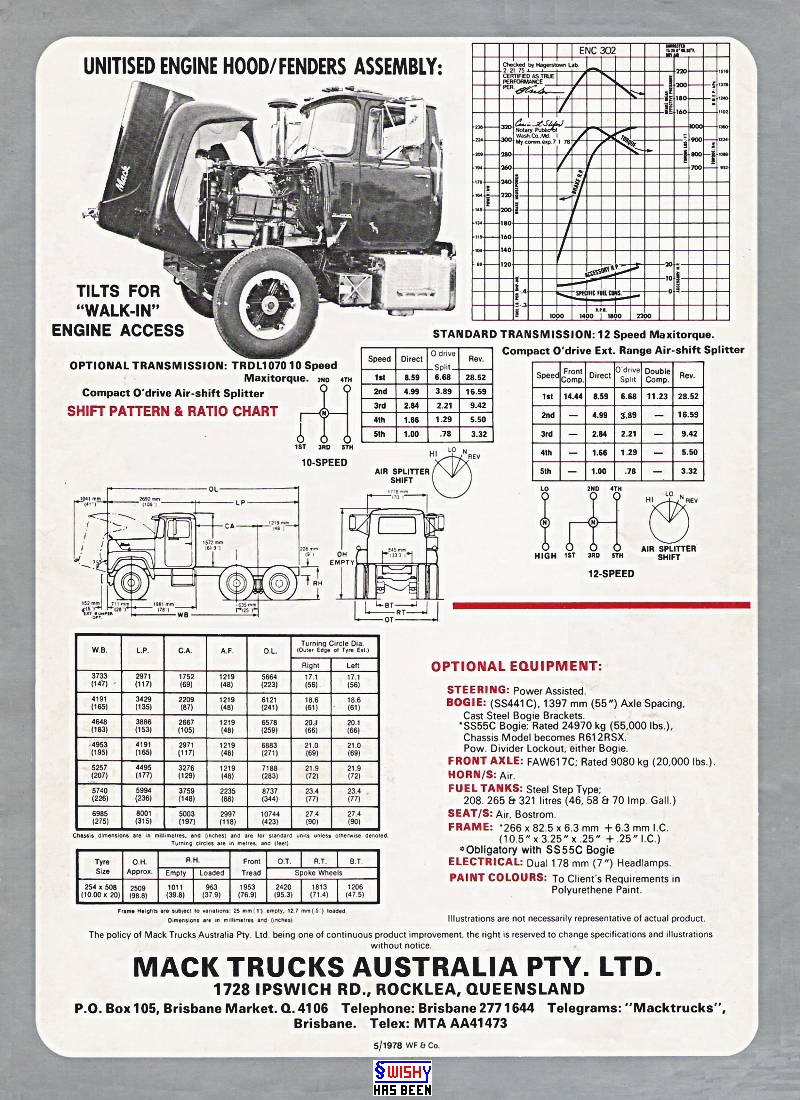

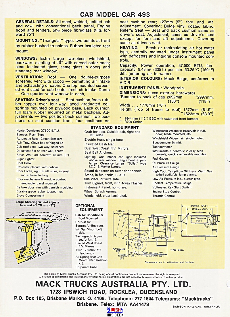

No Seed
Only the one 'R'model
the mack COE 'F' model had a full FG Cab most noticeable by the support strut go n from mirror to near the lower section of door
the L8r model had FG cab with steel doors n no mirror support
imageproxy.php?img=&key=a8b8d98f5855eef7s022.jpg[/img]
I'm not aware of a full FG 'R' model cab
