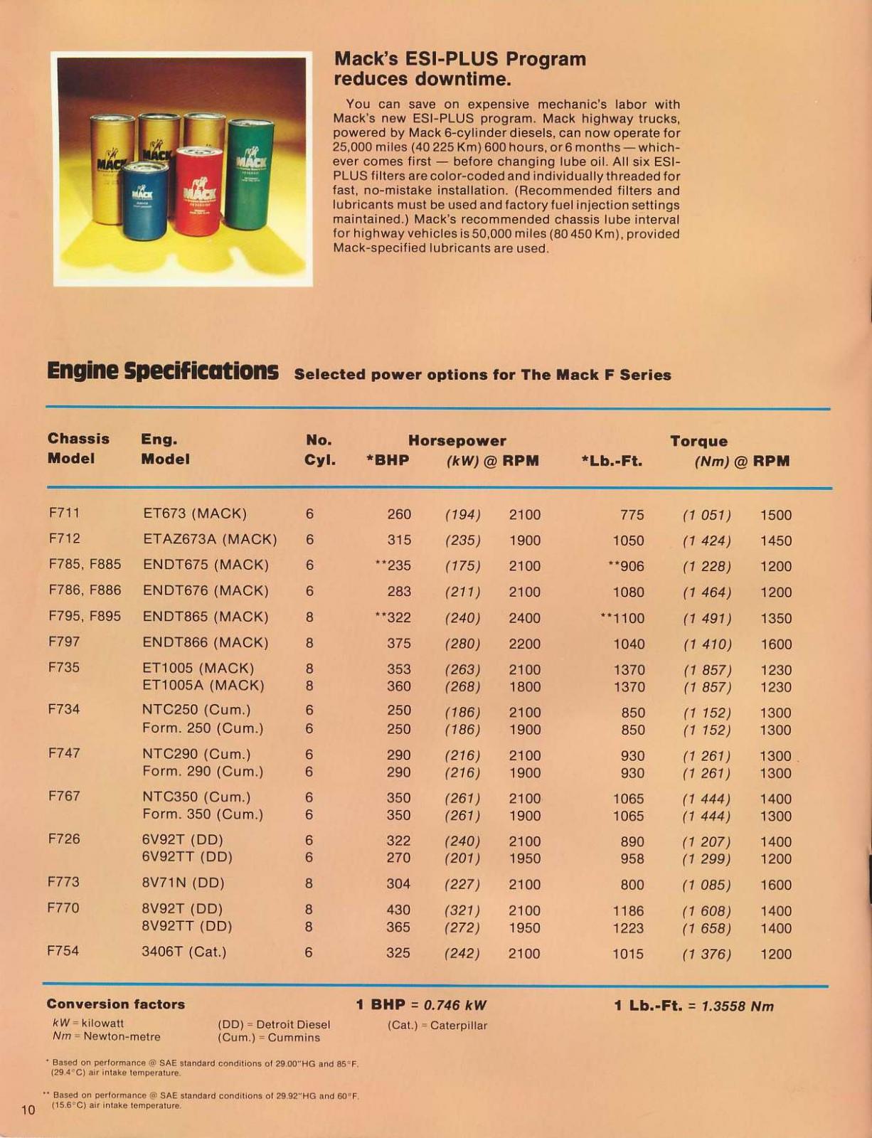

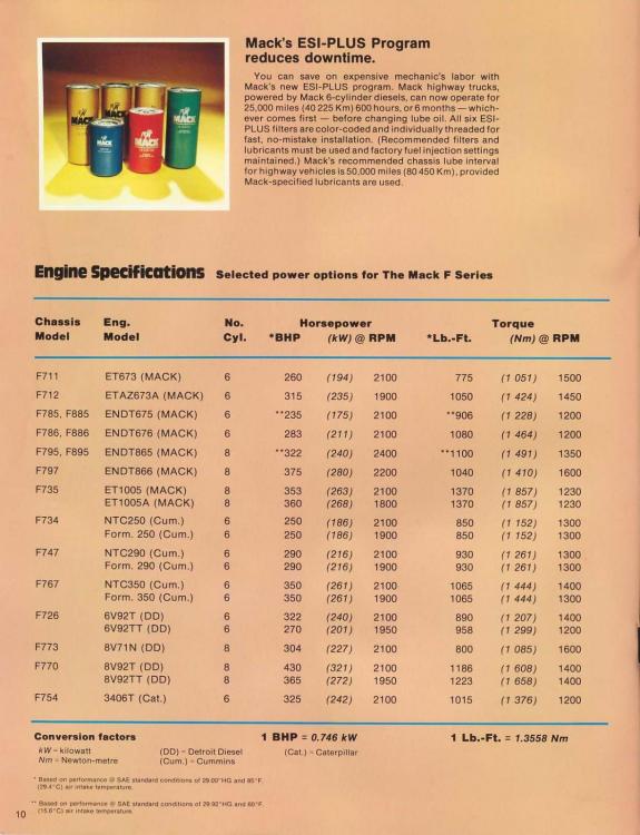

Interesting to note here the F735 is the Model number for the 1005 cabover I presume, at 353 and 360 horsepower. My truck model number is RW736 @ the 400 horsepower rating.
https://www.bigmacktrucks.com/topic/52028-etb1005-v8-engine/#findComment-388083

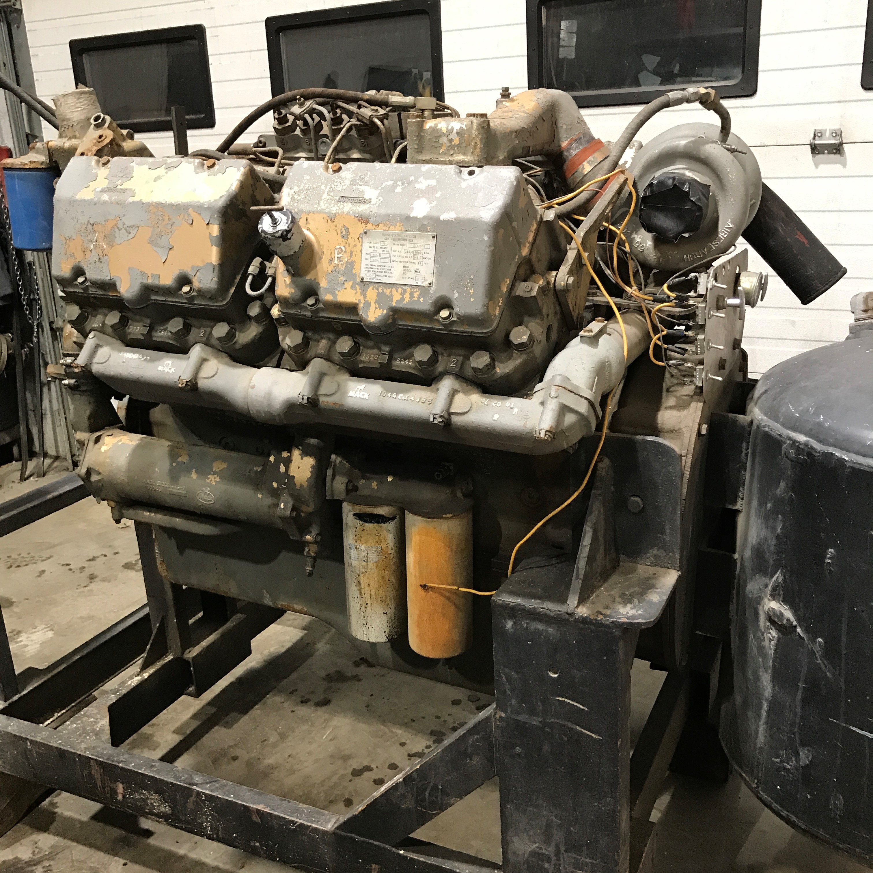

I got it started last night. Ill try to post a video.
https://www.bigmacktrucks.com/topic/52028-etb1005-v8-engine/#findComment-388118
2 hours ago, Yoos Brothers Construction said:
The one in my 1980 RWS721LST Superliner tri axle is an ETCZB1000. My engine tag is gone as well but I got this off the right front pan rail. An interesting thing on mine is that it has a the number 142(I think off the to of my head) welded to the block in about 3 inch numbers above the starter. The engine has never been out of the frame. The truck only had 52,000 original miles on it when I bought it. I've never seen such a thing on a E9. Also my injector lines are routed completely different than an E9. Mine has never been painted. It has the original red orange engine paint that Mack used in 1980. The history of these engines in the early days is fascinating to me. I have a picture of a R735S tri axle dump that my Dad looked at buying in the 80's. It was a test truck with the ET1005 in it with a 6 spd tranny. Also there is a cement plant in Meadville, Pa near me that had one that was tri axle dump as well. Both of these did not have air coolers.
Interesting to see the shift in nomenclature from the 735, 736 1005's to the more common (numerous) 721, 722 E9's ... my truck is indeed a 736 and like yours, a 1980 as well.
https://www.bigmacktrucks.com/topic/52028-etb1005-v8-engine/#findComment-388120
17 minutes ago, BGarofalo said:
The engine serial number should be on the passenger side of the engine on the oil pan rail. You will see a flat area. I would have to agree with 41Chevy, I think the number built is wrong. The timeline with the engine build dates just doesn't line up. Aside from a few differences they are pretty much identical to an E9.

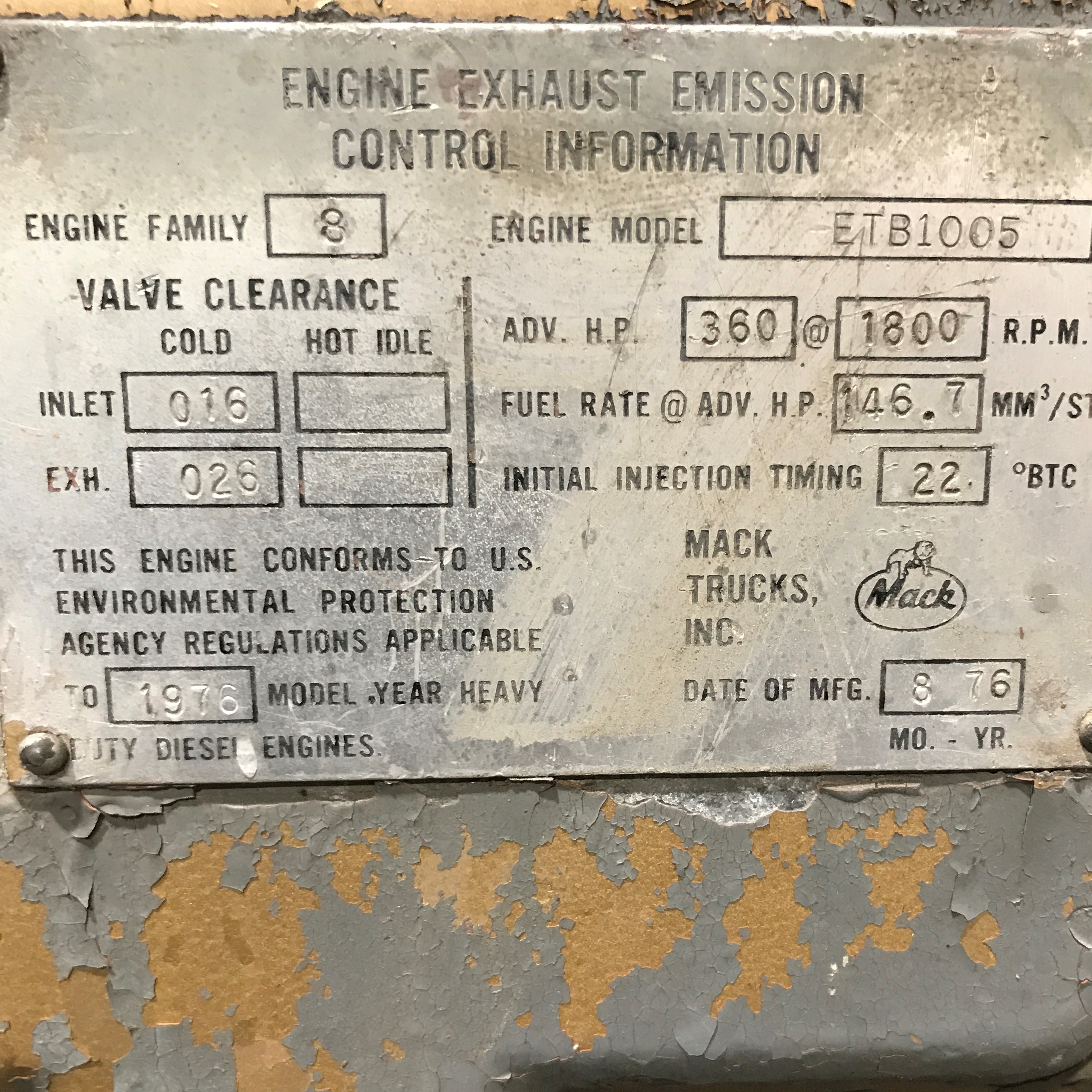

Two filter set-up there... before the ESI engines were introduced.?
I lifted this photo from the web purely as a reference for my truck... I assumed it is the same tag my truck should have had originally. This tag is on a 1983 RW721, and still called a 1005 at that time.
https://www.bigmacktrucks.com/topic/52028-etb1005-v8-engine/#findComment-388121
The tag says 1980 though. Mine is a 1000 not an E9 and is a 721 not a 736. The few 736 I've seen all had 1005s
