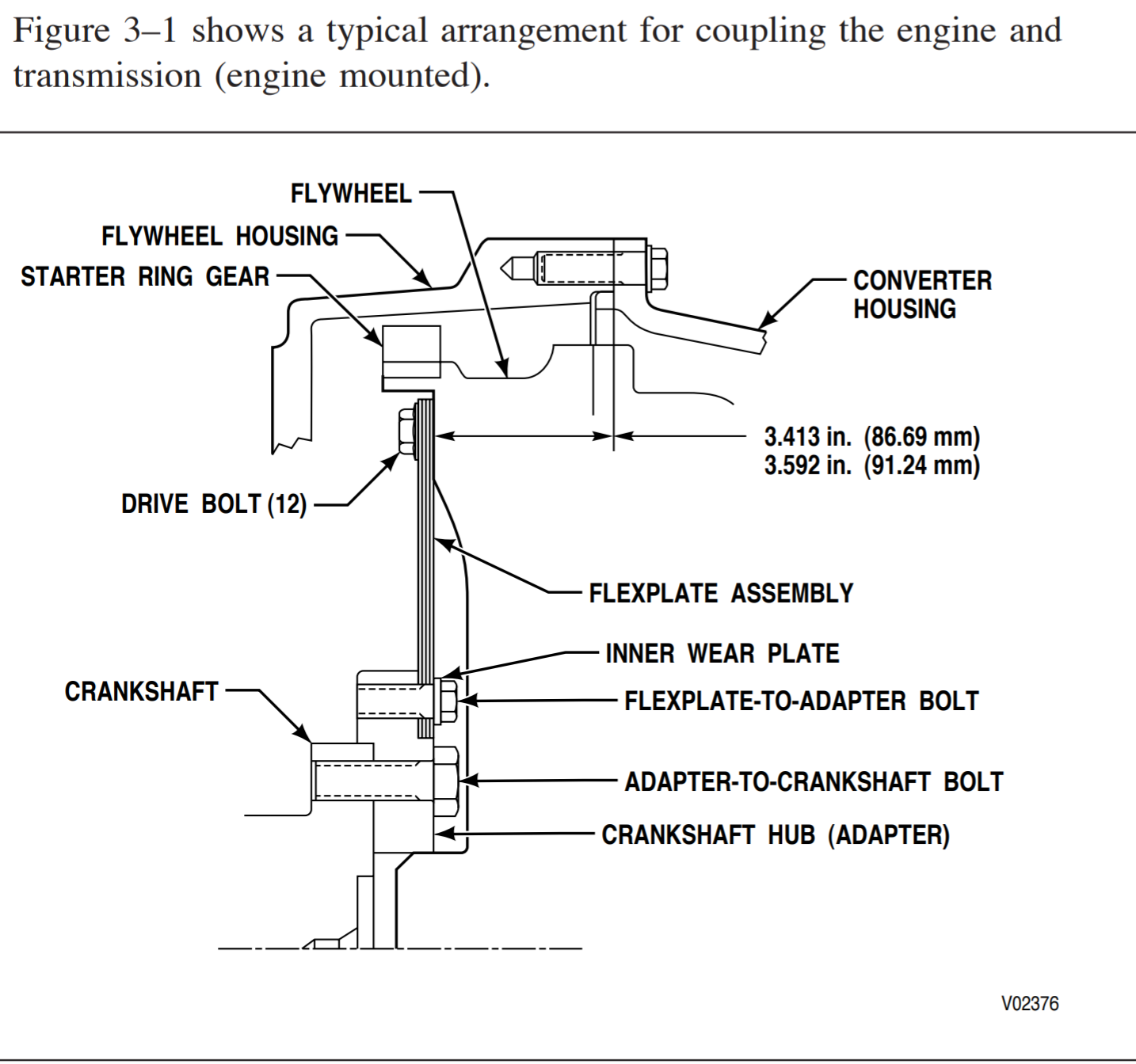

This diagram is what has me confused. It says to remove the drive bolts which in this application can't be accessed. So if I remove the 40 bolts around the torque converter and it stays in place on the crankshaft how can I then remove TC if its bolted from the opposite side.

as above... remove all the bolts from the flexplate through the aperture on the front of the bellhousing, these hold the flexplate to the torque converter... then remove the periphery bolts on the bellhousing and remove trans.... the flexplate will remain bolted to the crankshaft.
on refitting, before you get too many bolts on the bellhousing, start all the ones on the flexplate, they have a habit of being a little "off" if you bolt the trans on and have no wiggle room, maybe that's why it's called a 'flex' plate.

yes, remove the 12 drive bolts from the "front" access hole, usually there is a cover plate on the engine side, worse case is you pull the starter.. the 40 bolts are to join the two halves of the TQ, don't go there.
