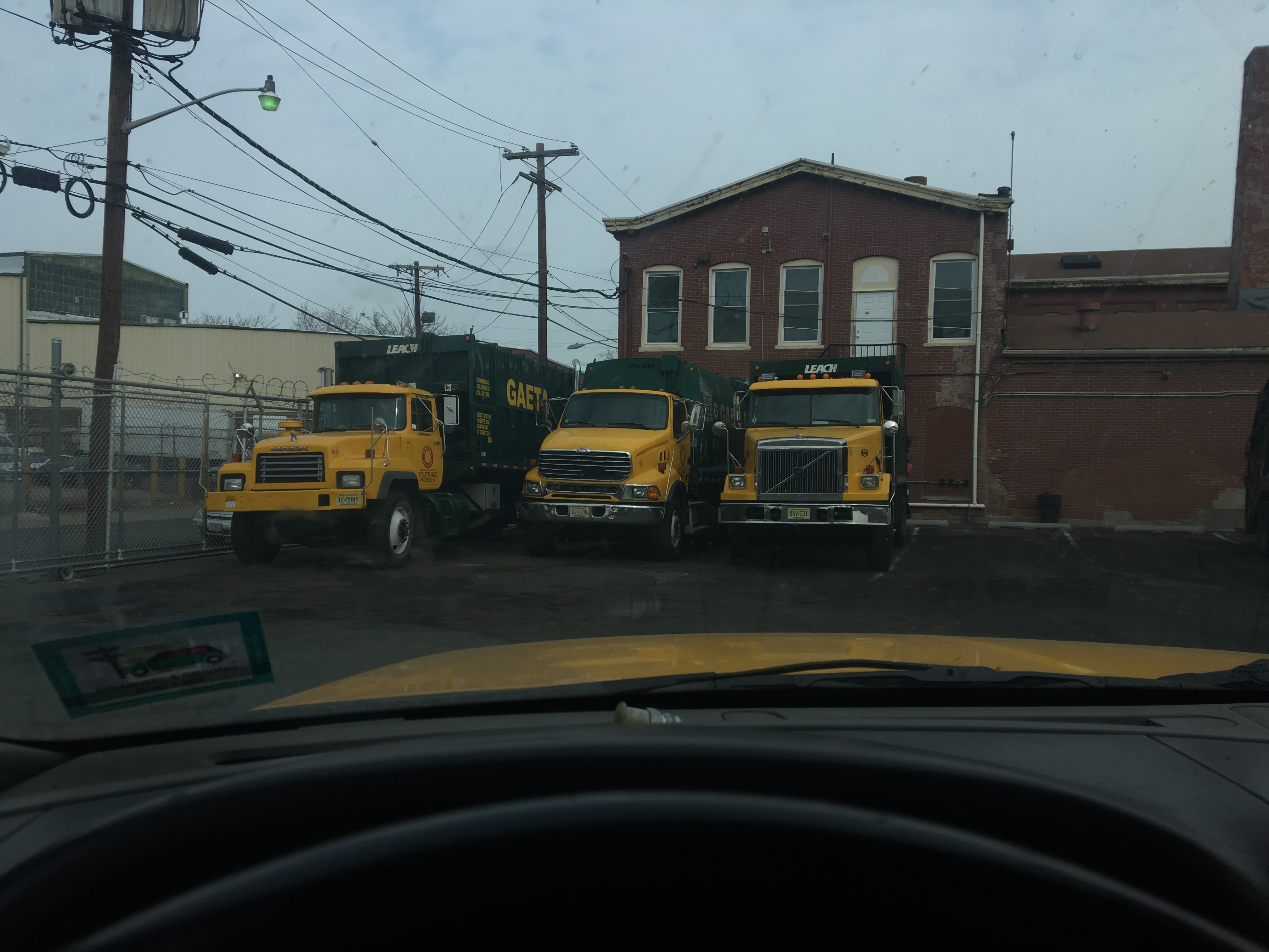

I just created an account on this page to ask question pertaining to this truck mainly. My work has a RD688, with a Leach rear loader body. I had it running the other day, and it just shut down. Now when I go to start it, you hear a little relay click in the glove box, and the dash shuts off like its cranking, but nothing happens. Batteries are fully charged. Cummins under the hood.
