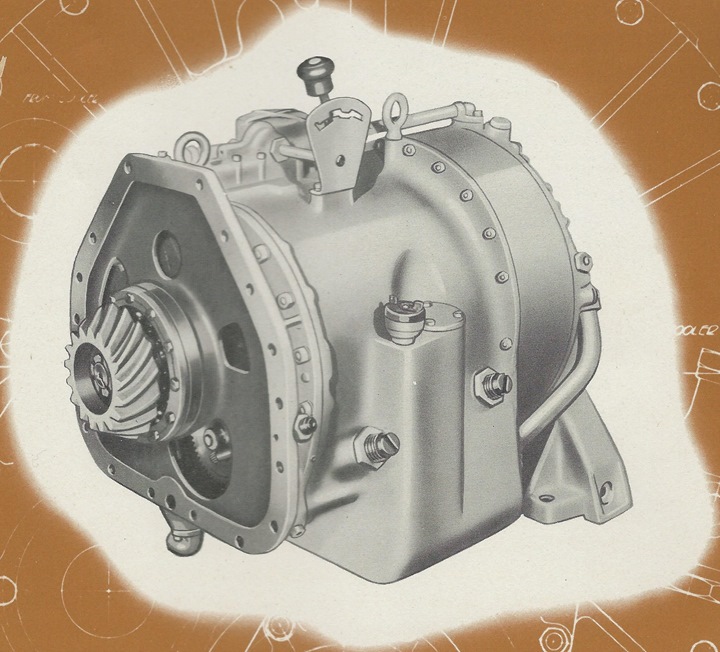

The Powermatic was a late WWII design for the M18 Hell Cat tank destroyer and the M26 Pershing as the Torq-matic and built by GM's  Detroit Transmission Division , all production was transferred to GM's  Allison division in 1946. I should have one in one of my containers from our '53 GMC potato hauler from when I yanked the 320 six for my 55 bel air gasser years ago.  Manual Valve body for gear selection. Bullet proof but weighs a ton.
