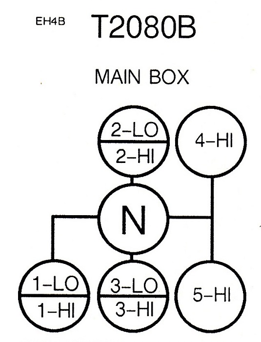

  On 2/5/2018 at 4:41 PM, j hancock said:
If you are running all the gears:  Start out 1L, 2L, 3L, then preselect "D", then 1D (fourth), 2D (fifth), 3D (sixth), etc...
Expand
Depending on conditions, you may not need to use one or more of the lower gears.
The shift pattern is below.
Jim

  On 3/15/2018 at 6:21 PM, Rufino V said:
IS not like 1 L 1H 2L 2H 3L 3H 4L 4H 5L 5H ?
Expand
You do not the hi-lo like a splitter. If off road used proper low range gear, when on pavement put range in direct and shift the main 1-2-3-4-5 in that order.    terry:thumb:
Expand
In the 2080 operation guide, Mack recommends not starting out higher than 3L (6.63).  The 5.24 ratio of 1H (fourth) is not practical to use for starting.
Jim
