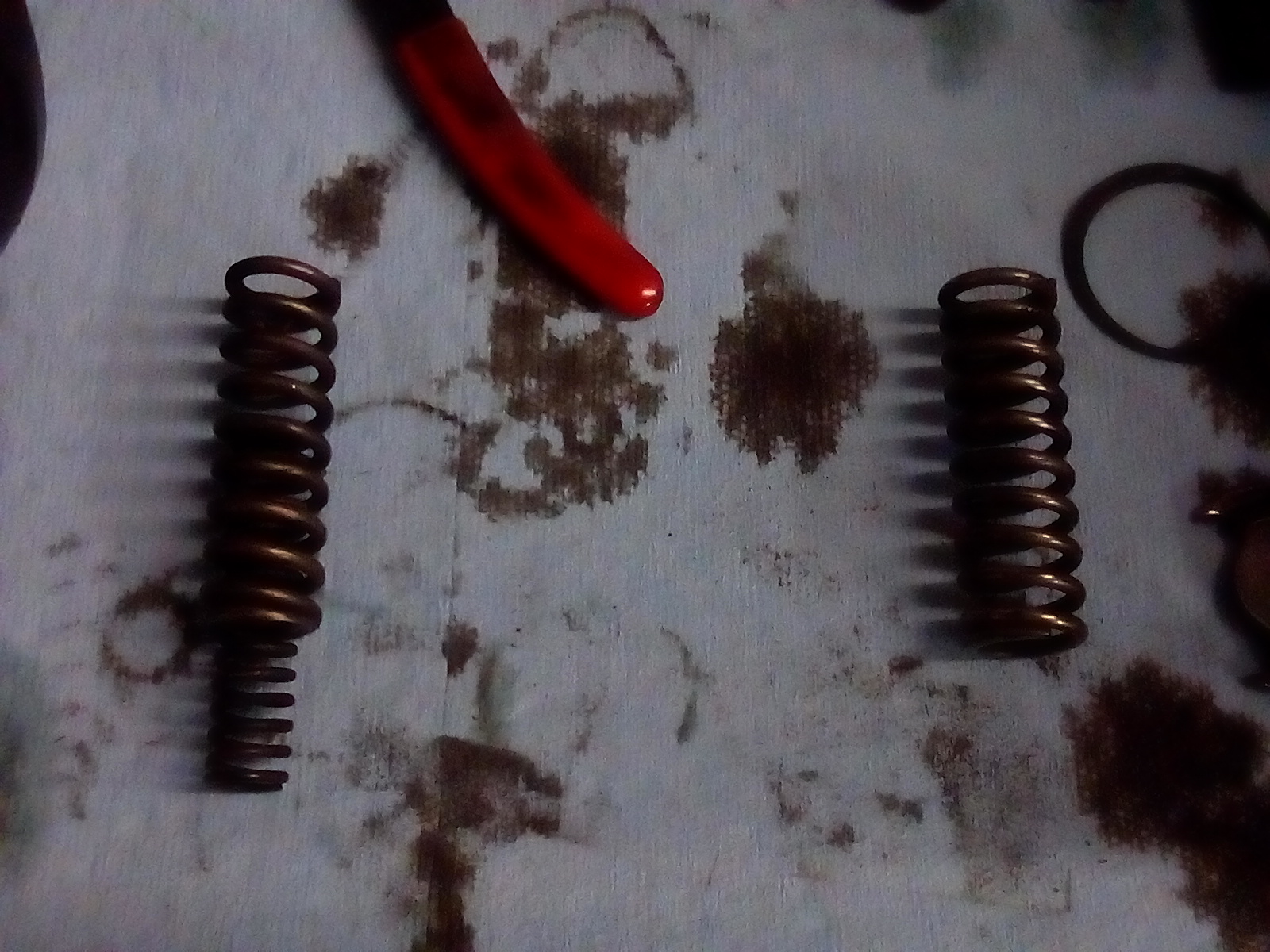

Tore my Jake's apart for rebuild.  Found one to have single springs in slave cylinder and the other has double springs like the kit shows.  Did someone forget them in the past?  Will they work okay or should I order them and get them installed?  Kit does not include them, only valve springs.

It's been awhile since I've rebuilt one with the update kit, but it seems like I remember the 2 springs were updated with just a single spring. Maybe the one housing has been rebuilt but not the other? It's also possible that my memory sucks and I'm wrong.
I know they both had different solenoids on them so I know someone has been through them at some point.   The paperwork that came with the kit shows TWO springs, so I'm guessing the two springs are the upgrade(not the other way around).  Of course the kit doesn't come with the springs.

Went to hardware store and bought three new springs of same diameter and wire size.  Trimmed about 1\2" off so same length as others.  Put it together and sitting on motor.  Need three more bolts to mount it and the run valves.  Little by little.....
