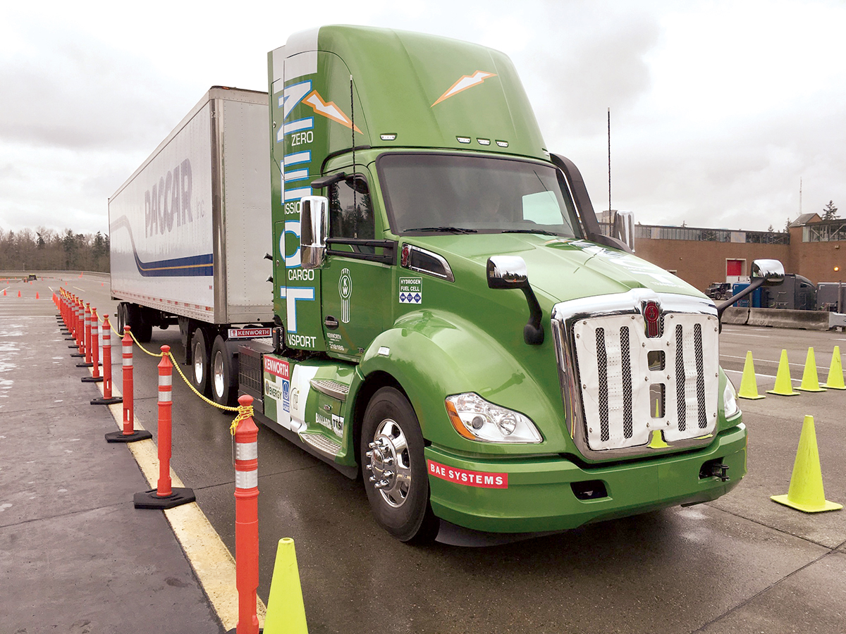

MOUNT VERNON, Wash. — Kenworth Truck Co. is wrapping up tests on a zero-emissions hydrogen-electric Class 8 truck that will be operating in drayage applications in Southern California by the end of March, company executives said.
California has set a goal of having 100,000 zero-emissions freight vehicles in operation by 2035, and the Port of Los Angeles and the Port Long Beach, where Kenworth’s Zero Emissions Cargo Transport truck will operate, have included zero-emissions trucks into their latest clean air action plan.
“We are developing a path to production” for the truck, whose only emission is water vapor, Stephan Olsen, director of product planning for Kenworth, told Transport Topics Feb. 6 at Paccar’s Technical Center here.

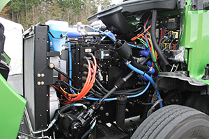

The ZECT truck, which produces little engine noise when compared to a diesel, carries 30 kilograms of hydrogen behind the cab in six tanks, each pressurized to 5,000 PSI. Refueling with hydrogen can be done in 15 minutes.
Instead of an internal combustion engine, a fuel cell sits under the hood and produces electricity by combining compressed hydrogen and air to generate the current. A battery stack, weighing about 2,200 pounds, is located below the seats and stores the electricity. Related cables, lines and systems add another 1,500 pounds. A dual-rotor electric motor propels the truck with an output the equivalent of 565 horsepower. The truck is capable of carrying 80,000 pounds and uses an automated manual transmission.
In all, it weighs in at 22,000 pounds, or 6,000 pounds more than the diesel-powered version of the model T680 truck.
The truck has a range of 150 miles and can operate for 30 miles on batteries alone.
The system also can recharge the lithium-ion batteries for use later. A hybrid drive setup manages the power from the fuel cell to and from the batteries as well as the traction motors at the wheels and other components, such as the electrified power steering and brake air compressor, according to Kirkland, Wash.-based Kenworth.
Total Transportation Services Inc. will lease the prototype ZECT truck from Kenworth and operate it at both the Port of Los Angeles and the Port of Long Beach, the two largest ports, respectively, in the nation, Kenworth said.
The truck will be fueled at the carrier’s yard.

Also, Kenworth’s zero-emissions truck has more electronics compared with a diesel or natural gas engine due to all of the systems that require electricity.
“We are also controlling the batteries, fuel cell and the cooling systems — all electronics,” Lindgren said.

The truck will have the ability to go 30 mph on a 6% grade, can reach a top speed of 65 mph and has enough torque to get started on 20% grade with an 80,000-pound load.

Hydrogen Fuel Cell System - Ballard Power Systems (* Ballard made a lot of noise about fuel cells in the second half of the 1990s but nothing came of it.)
Electric Propulsion System - BAE Systems (there's a military dual-use application at work here with discreet government funding)
  • Engine: Ballard Power HC85
  • Traction Motor: Dual-rotor AC motors, 420 kW or 565 hp
  • Transmission: Automated Eaton 4-speed
  • Brakes: Bendix Air Disc ADB22X
  • Fuel capacity: 30 kg of hydrogen
  • Battery capacity: 100 kW-h
  • Batteries: XALT Xpand 650 VDC
