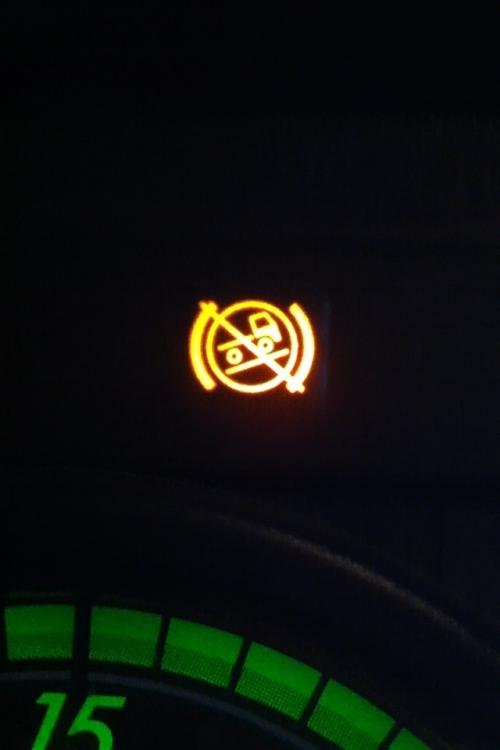

I have a 2016 freightliner cascadia at work.  It has the DD13 and a 12 speed automatic.  I have it since new and it has around 190,000 miles on it.    Since new my no wheelie light come on every now and then.  Does anyone know its real meaning?   Company is to cheap to include owner/operator manuals in our trucks.image.thumb.jpg.3ce5b70acf426fd1c8933dbe865be29a.jpg

Hill Start Aid Over Ride warning light. Basically a hill holder system
Would an automatic transmission equipped truck need that? I've heard of those in passenger vehicles with manual transmissions. Not saying you're wrong, that question just popped into my head when I was reading your answer.

Obviously a different type of truck but my automatic F250 has a "Hill Start Assist".
I'm feeling not so smart so I'll ask why would an automatic need hill start assist? Isn't that what your left foot on the brake would be as you started to lean on the go pedal you lift you left foot off?

 Ricky told me........It's a HSA or Hill Start Assist. It's only used on manual automated transmissions. The button/switch is to tell the transmission to tell the ABS not to hold the truck when the brake pedal is released on a grade. The percent of grade is programmable into the TCM up to three percent grade. The Volvo I sit in and aim has one with an IDrive 12 speed.    .....Hippy
