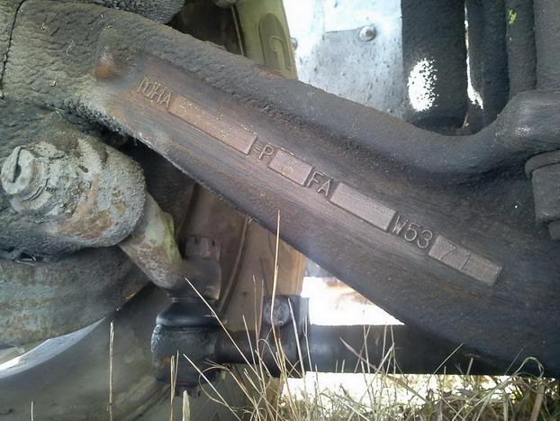

I have a '93 RD690S and I am trying to determine what size axle I have on this truck. I have looked at the data plates inside the door jambs and there's nothing.
The number on the front axle is 3QHF5448 .
The VIN for this truck is 2M2P261C1PC014198
Is there a site that let you look up this build info for Mack trucks?

Check out the other side of the axle beam. There should be FA and so on. I'd expect seeing FA W538 14000lb on your truck but this could vary.
