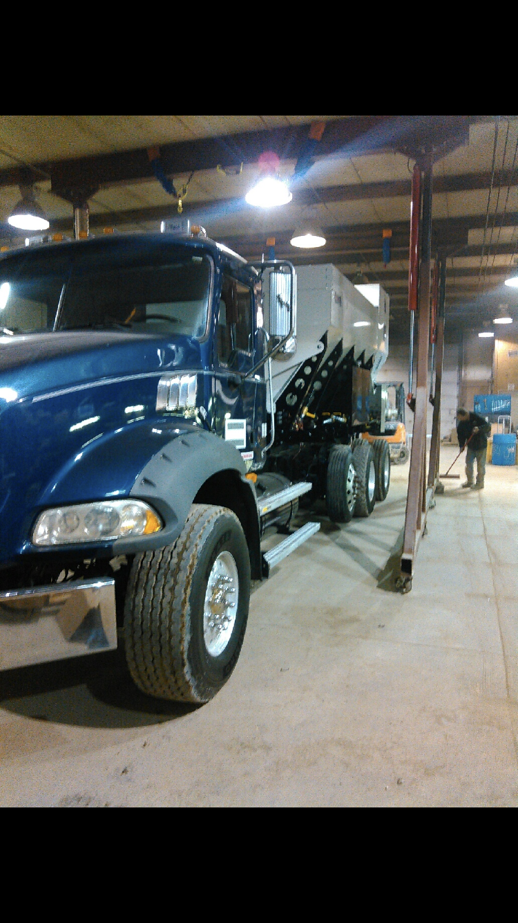

I love the granites. And it looks pretty good for an 08 and the mileage is really low. I just hope the injector issue gets resolved and let’s the truck get out and earn it’s keep. I do wish it had an mp8 instead of the 7 but we’ll see how it does
I wouldn't disrespect any hard working truck, but the instructor at the Mack Engine training advised the same........to stick close, whenever possible, to the MP8 platform. His opinion seems to echo's yours.
Our 2012 mp8 has pretty much been a reliable hard working truck. We have had our fair share of issues with aftertreatment system . Basically replaced whole system twice since 2012. But the motor has treated us well. A water pump and that was basically the extent of repairs besides accessories like fan clutch and air conditioner compressor.
