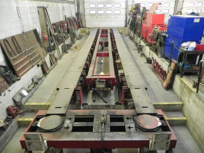

They use a Bee Line frame table. No heat, no major disassembly all laser and computer specs to check and make it factory. If you can find a shop near to you with the Bee Line system thats the best and most economical way. Sure there a shop Westchester with that machine.
Here is a shot of their chassis table.

$3800  and was on the machine for 2 1/2 days, cheap IMO

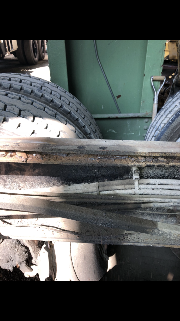

I have a double frame and rust started eating between the rails separating them... so much so on the back of the truck that my dump body doesn’t sit on the rails flush like they used to. I had to weld plates on the dump body rails to help shim it a little but it’s still not perfect. While driving it sounds more like a roll off carrying an empty box that’s not chained to the rails rather than a dump truck...
Wish we'd known that when this thread started months ago- Sounds like you may have a structurally questionable frame even before it was hit. If the frame is shifting around enough that the dump body doesn't line up with it anymore, it clearly can warp around and throw the powertrain alignment off in more ways than can be easily counted.

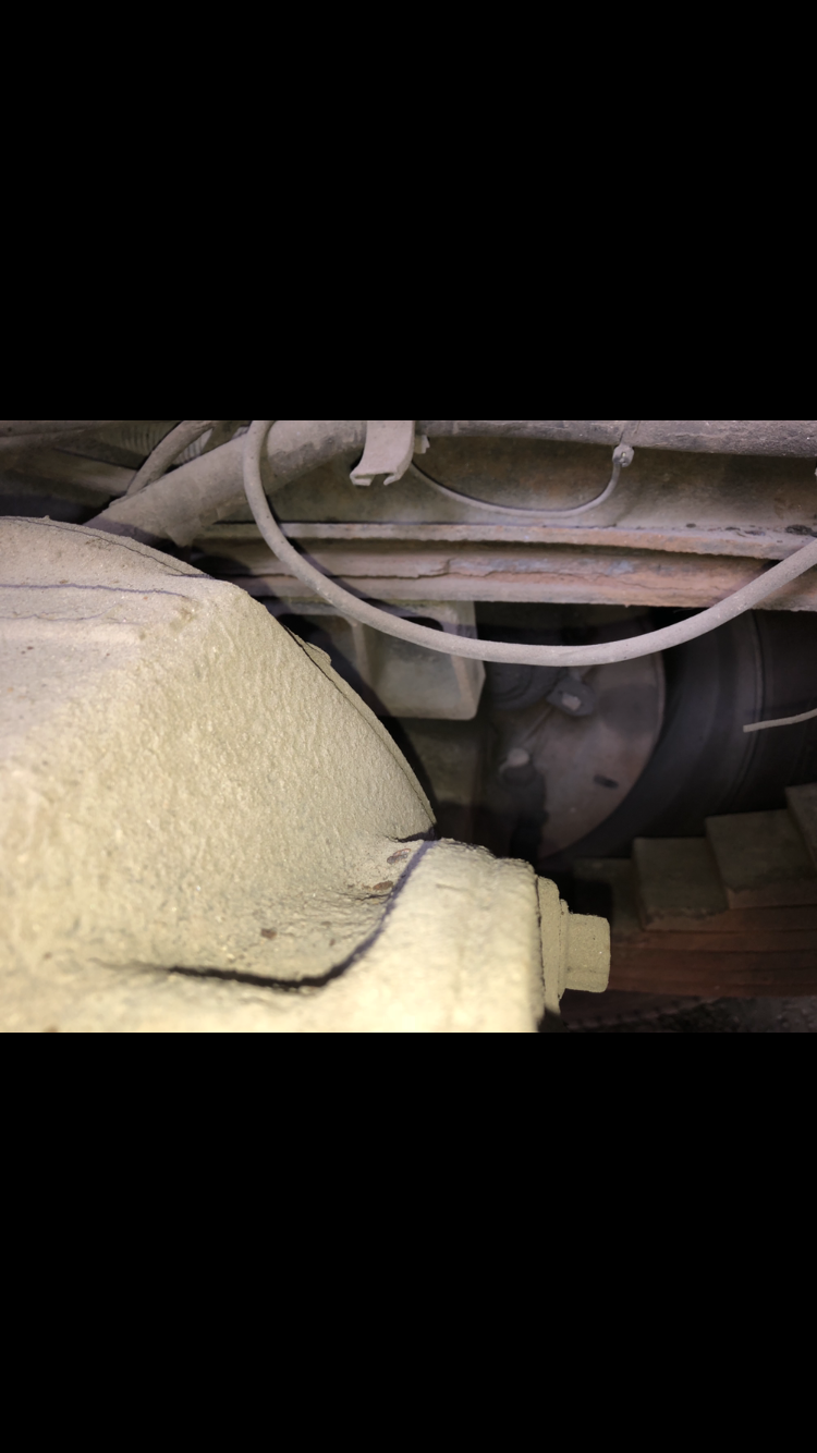

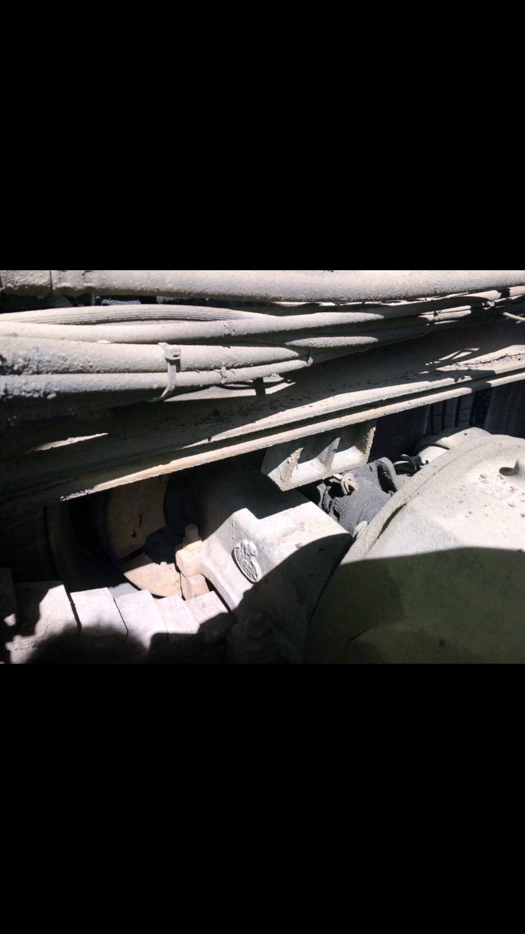

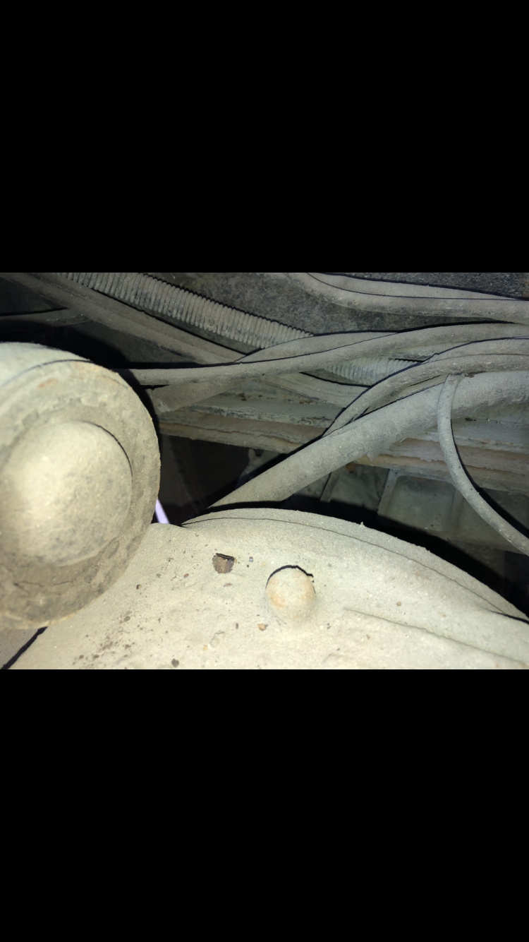

To be honest, every time I get under the truck to grease it and what not, I never saw the frame rust and separation past where the dump lift cylinder is.. I never thought much of it. Everything else seems tight on the truck. I’m gonna take some pictures tomorrow and post them maybe you can tell me how bad you think it looks... I know looks probably don’t mean as much as measurements do though. This is all a learning experience for me. I always thought a truck frame was STRONG. Especially a double Mack frame. I never thought these things were possible. Naive guess, or just dumb.
