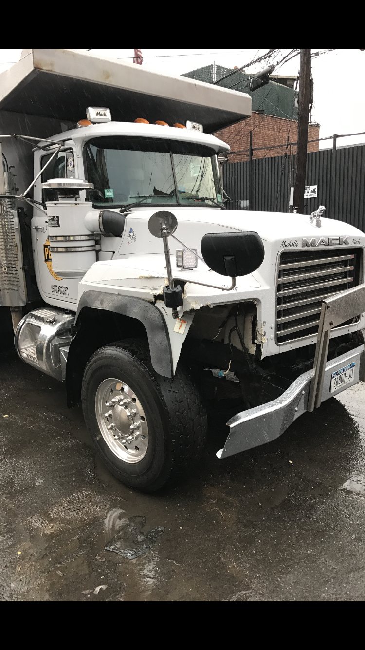

mack did the inframe about 4 years ago. Everything seemed fine then I started having a problem after my truck got hit in the front after someone in my yard slammed into the truck with a front loader

The impact did not look any kind of substantial to me from your photo. More cosmetic and maybe a frame rail bend but both easily repaired. I do believe you will find problems with the rotating/reciprocating assembly. Once you get the thrust and bearing clearances figured out there are several more areas to explore.

Those front bumpers ain't easy to bend and they're functionally part of the frame assembly... Perhaps the frame was tweaked?
They aren’t ... and that bumper was 2 weeks old when that happened... I put a new bumper on because old one lost it’s shine then that happened.. and the shoemaker body shop saw it was new so he made a cut on each side and bent it back then welded reinforcements on the insides of the bends probably hoping I wouldn’t notice.. when I did he gave me some bullshit that he was trying to save me money... $9000 for that repair and he couldn’t put a new $600 bumper... everyone is a bunch of shoemakers in the nyc area

Front bumpers fold like paper when they contact dirt, another truck, or in this instance an end loader. They pull back fairly easy too with controlled hydraulic force but it should have been replaced in your case if insurance was involved.
