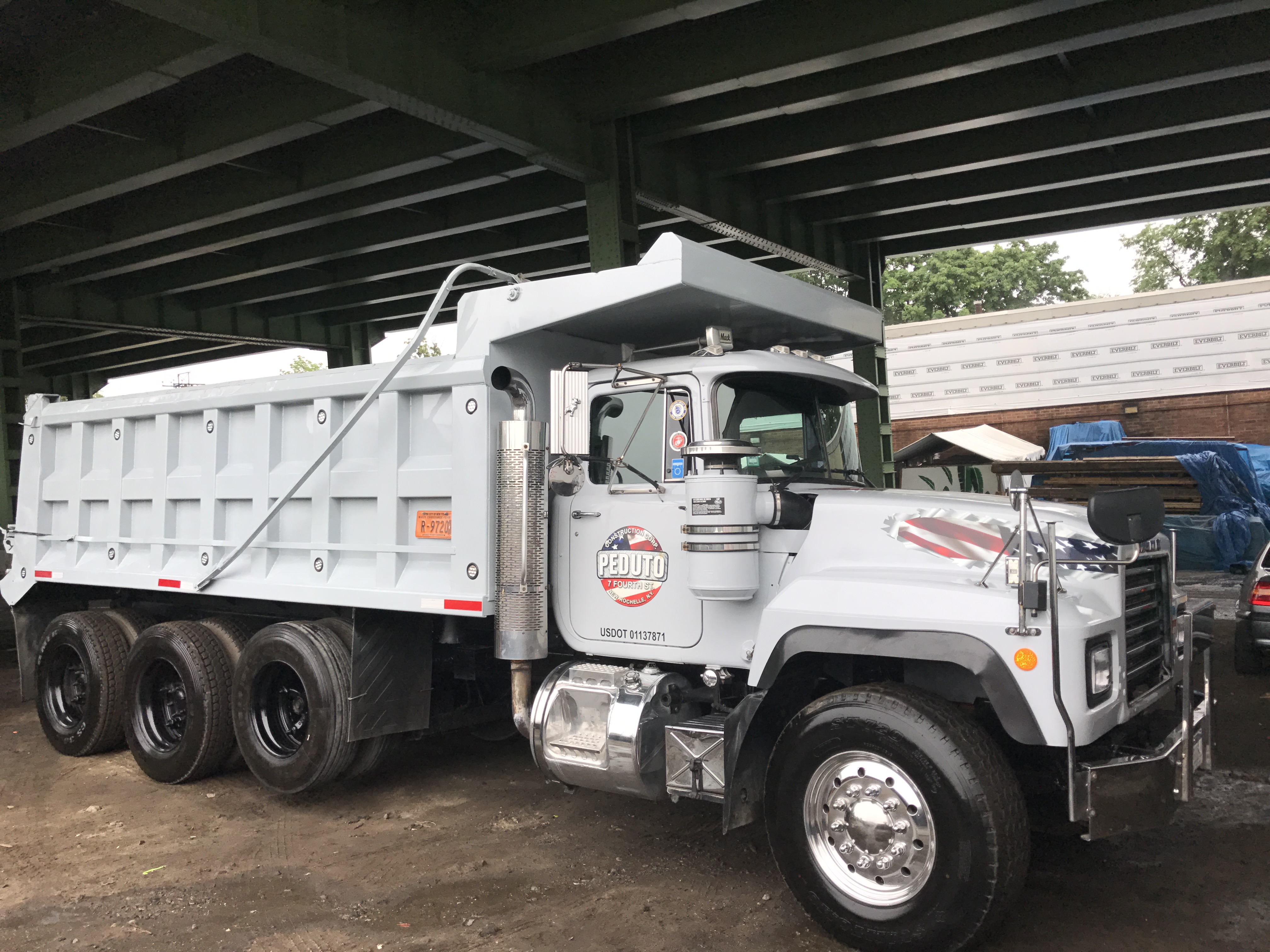

The truck damage picture was spontaneous, but looks like it just came off a show, so confirmed. Tank looks like it gets polish once a week.......

I really try to keep it as nice as I can considering it’s an 18 year old truck... this picture was after I fixed it when the loader hit me . I painted the body and put lights in as well.
