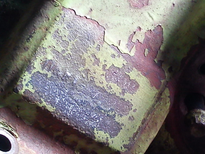

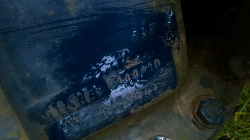

2 hours ago, KKERGALL said:
what is the " 11KHA " stamped on  flat machined surface on carrier? Rich
It's KHA 5444 P10 on CRD93.
I have another one of the same time frame but that one is impossible to read. But I can tell for sure there's also P10 in the end.
The banjo stamping is 1QF51218P6 S441C, just for some reason.
Edited by Vladislav
On 11.03.2018 at 10:39 PM, KKERGALL said:
A trick my Polish unit man showed my when I worked @ Mack dealer, use a paint marker go over the stamping on carrier and wipe quickly w/rag and you can make out the numbers.
Thank you for the advice. I'll try that for a practice.
I found one of such carriers in my shed apart from the axle housing and could read the markings on the bearing cup without removing it. Didn't write the # on a paper but those are not the ones I need.
