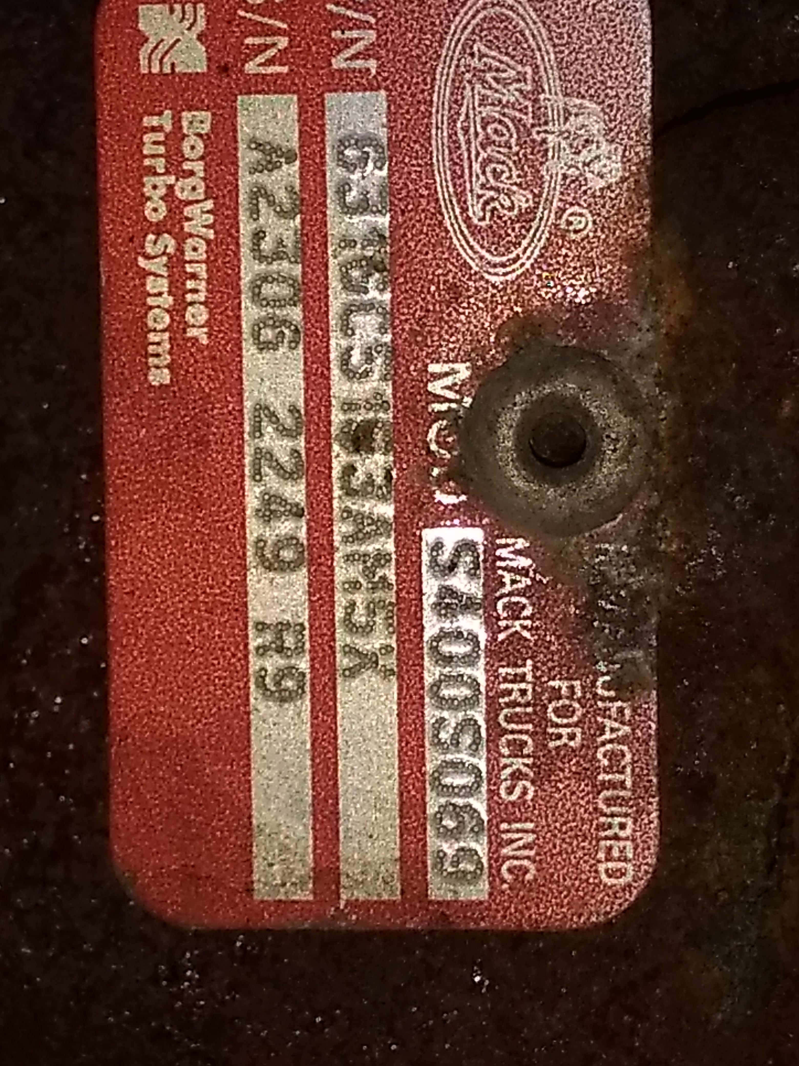

Ok guys I really need help today out of no where turbo took a turn for the worst..Mack wants 1900.00 anybody know a better price place to get 1 ..also it tried to run away but let off the couch and shut it down very fast still has oil in the pan.. anything I should look for..
