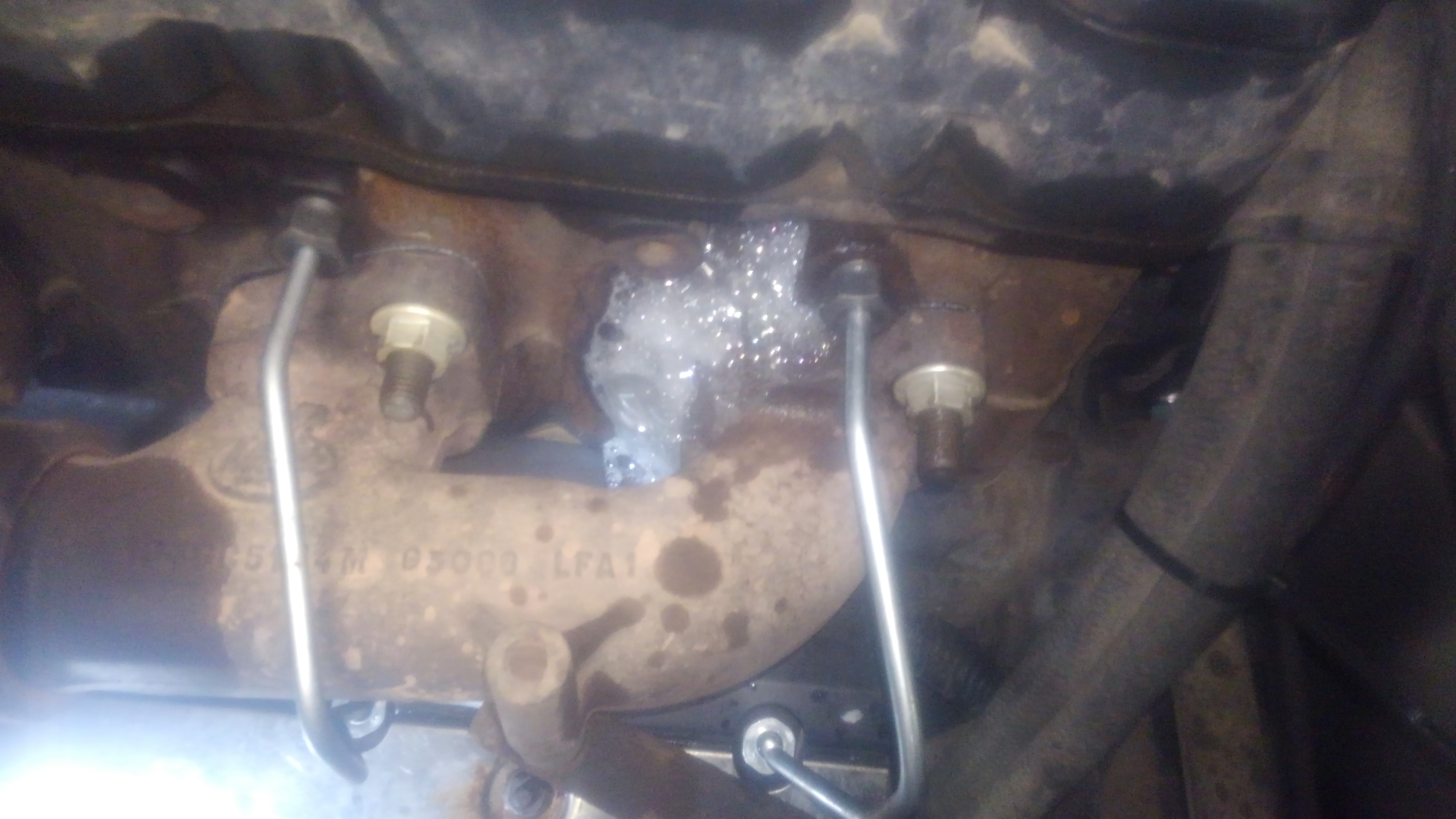

Windex on the exhaust manifold right after a cold startup works amazingly well. a couple very slight exhaust leaks and a big one on #1 really kind of a bummer but hopeful that is my noise. tried slight over torque on 1 and 2 hoping it would seal it up but it looks like i have to try again on the exhaust manifold. ether that or run it and it will ether pack with soot and seal up or mostly likely burn the gasket out. i think the air is squeezing threw a pretty small area causing more of a chirping sound than what i would expect from a exhaust gasket.
any tips to help a problem exhaust manifold seal up?

lower studs that break into the push rod tubes got a little high temp rtv the upper studs witch are just a blind hole just got copper high temp anti seize. did not see any cracks in the manifold. the leak is bubbling from the gasket itself.

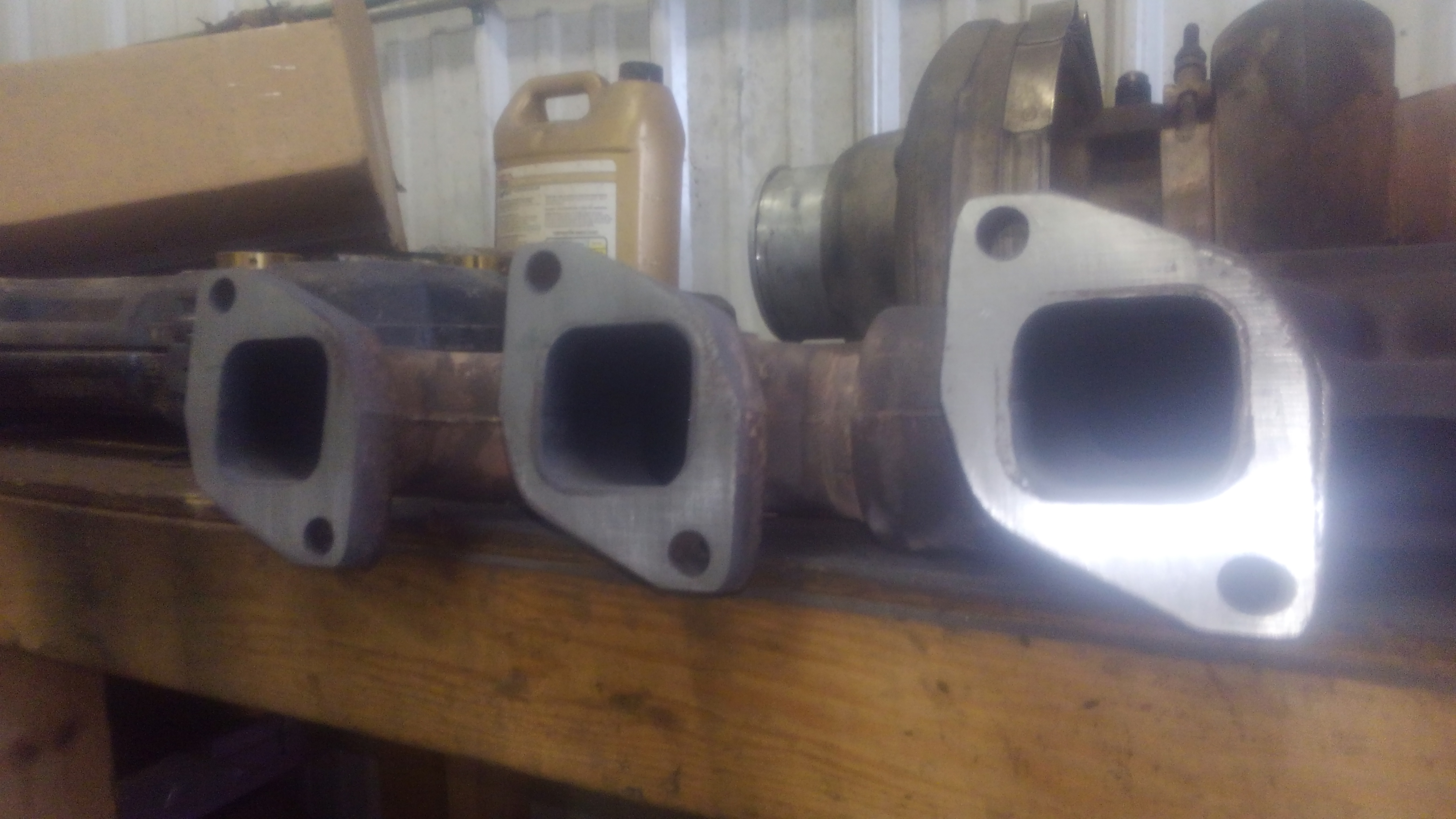

gasket surfaces were a bit rough number 1 was not leaking previously #6 had a blowout in the gasket witch actually didn't make much noise at all. number 6 seems to have sealed perfectly this time but #1 is leaking pretty bad #2 has a very small leak 5 got a couple tiny bubbles as well. but #1 is certainly leaking enough to be a problem.
