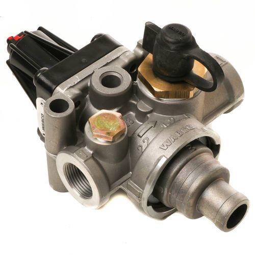

Where is the unloader valve
So I don’t know anything about these systems. From looking around it looks like your unloader valve/governor is built into one and looks something like this picture. Might be a little different.
