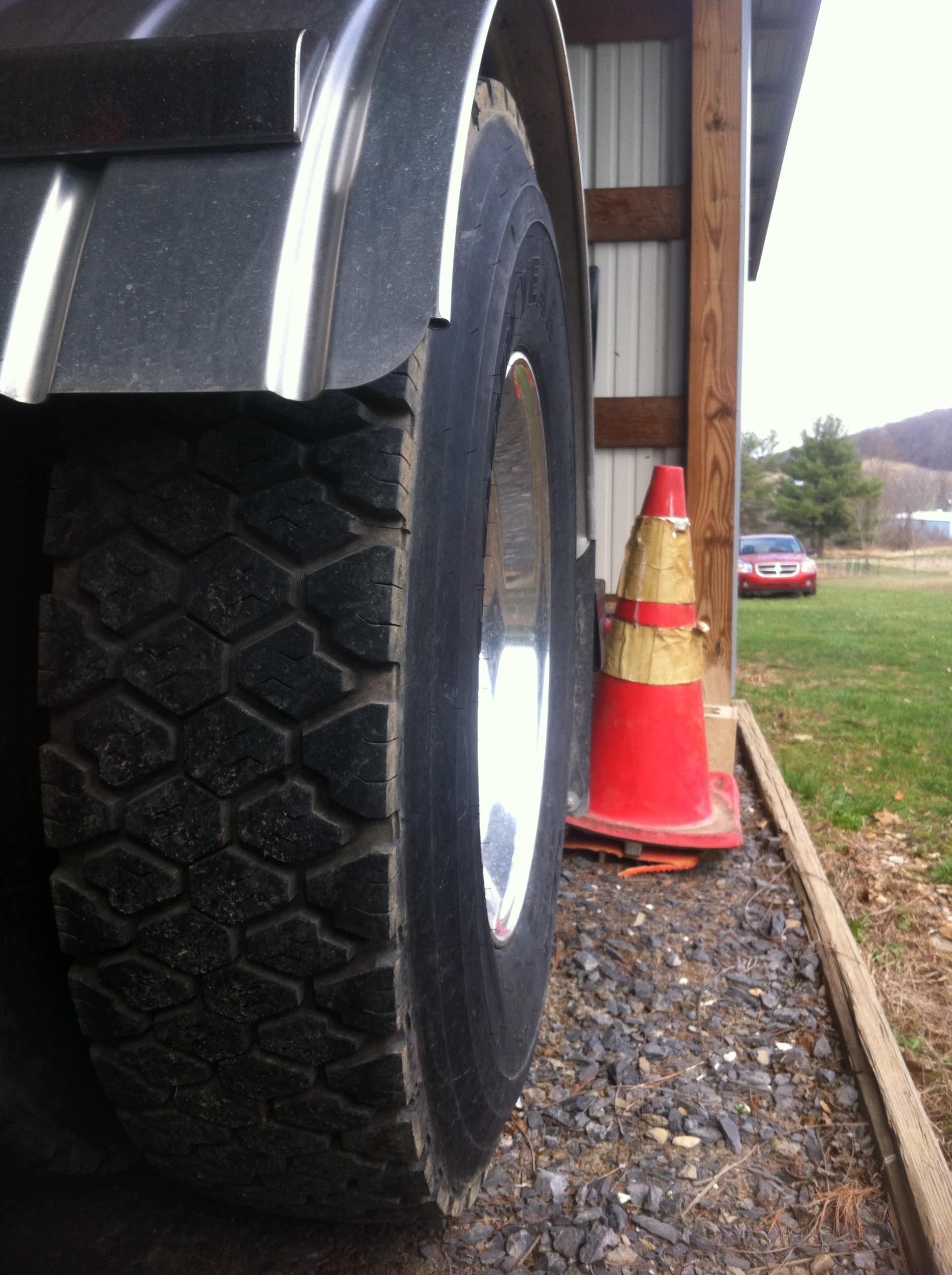

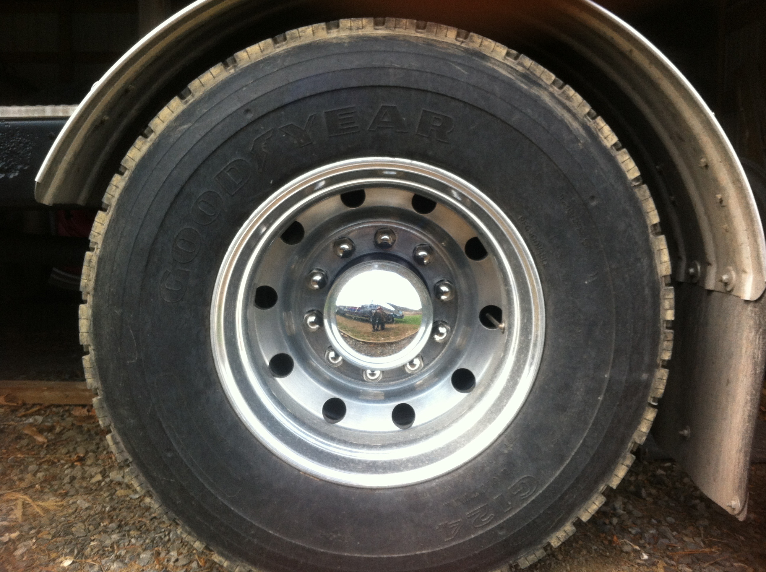

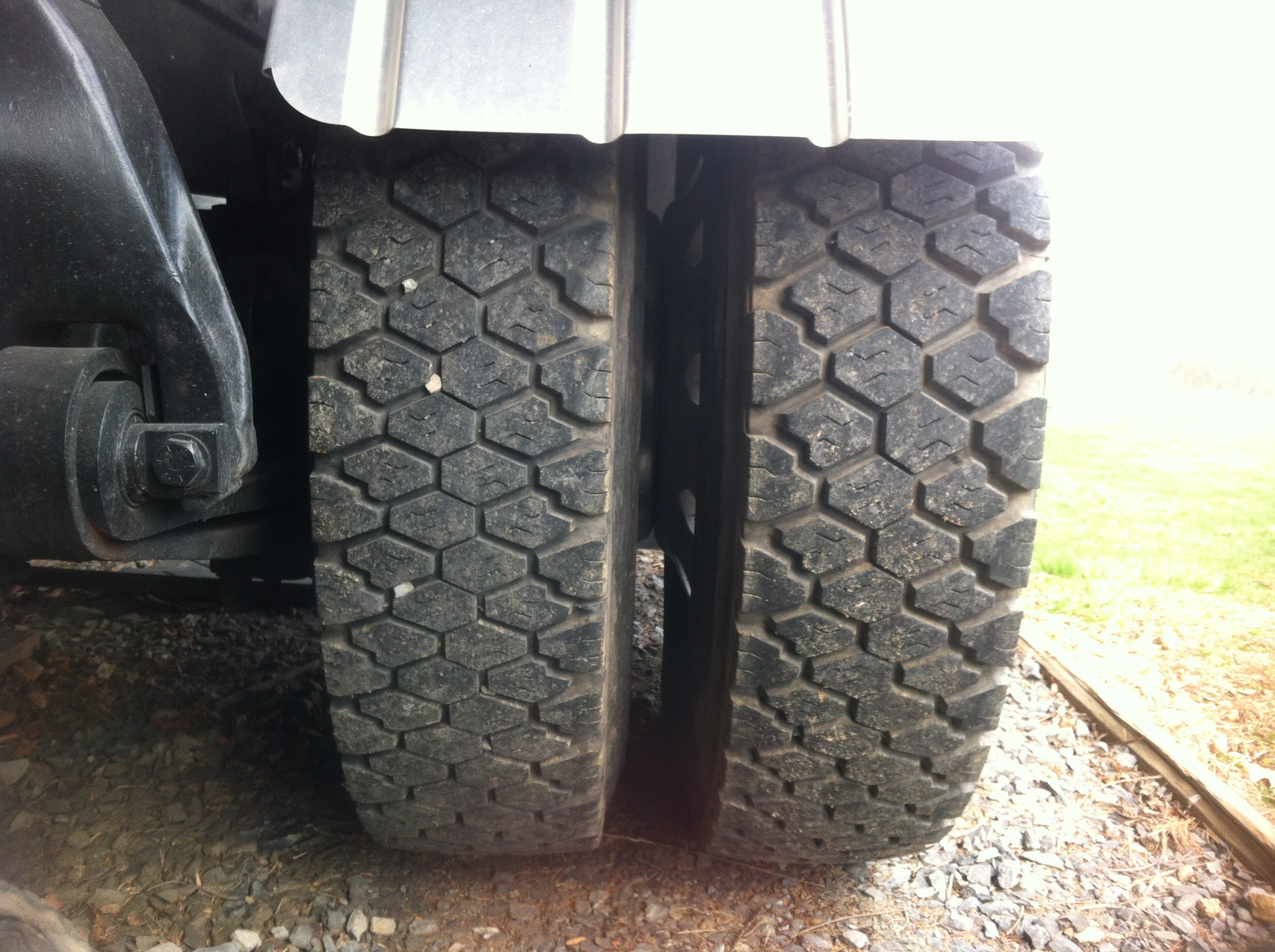

On 4/4/2018 at 9:23 AM, Hobert62 said:
I have 12r-22.5 on my B.     they are the same height as a 11r-24.5
Can I run 12Rs on an 8.25" rim or does it need a 9" rim??

I think Antrim diesel is of I-81 in southern pa around green castle area.       As for the 12r 22.5 I read one place that said 9" wheel and another place that said 8.25" - 9" wheel.   I have them on a standard 8.25" wheel and they fit nice with no excessive bulging or anything.
