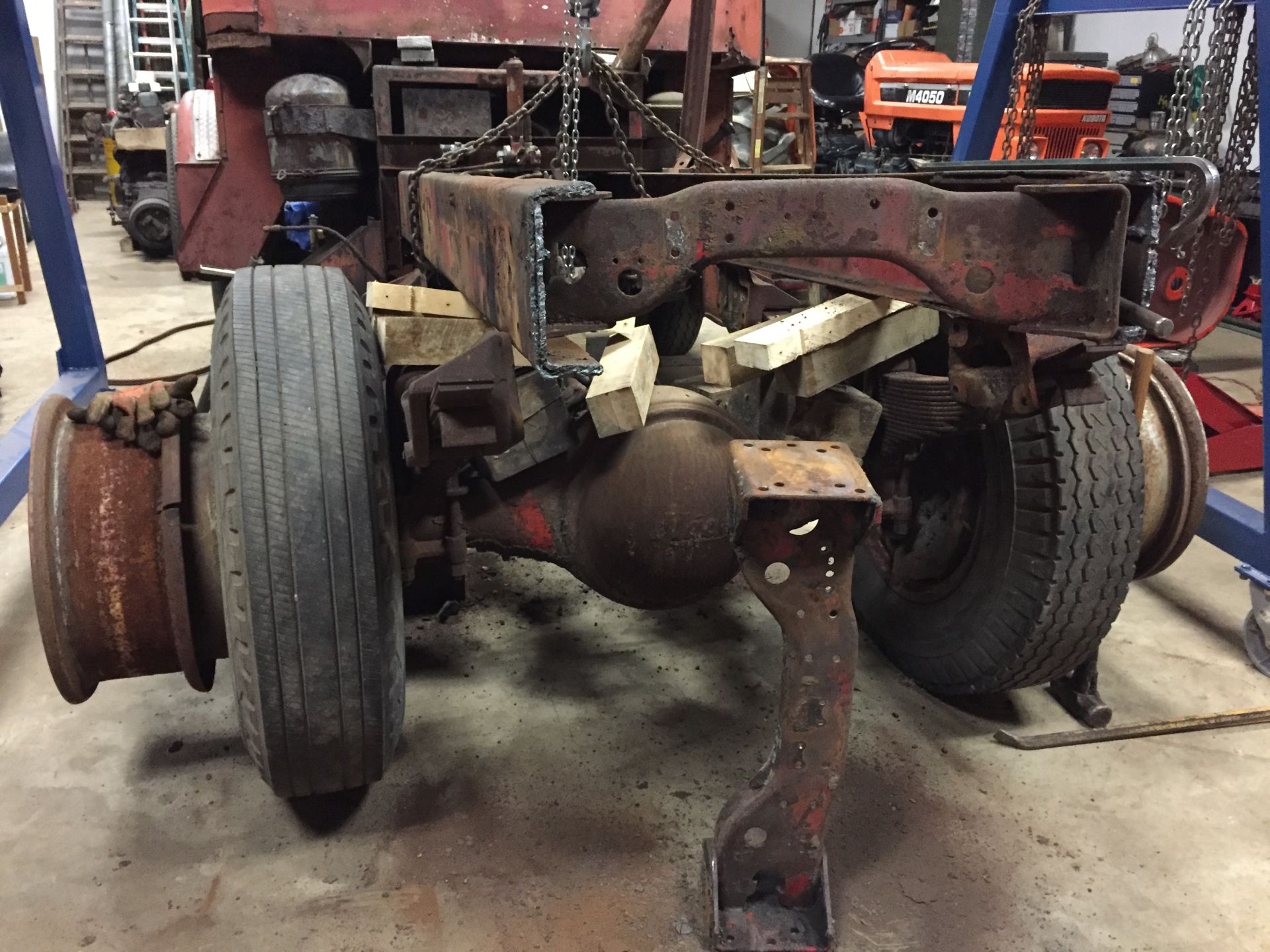

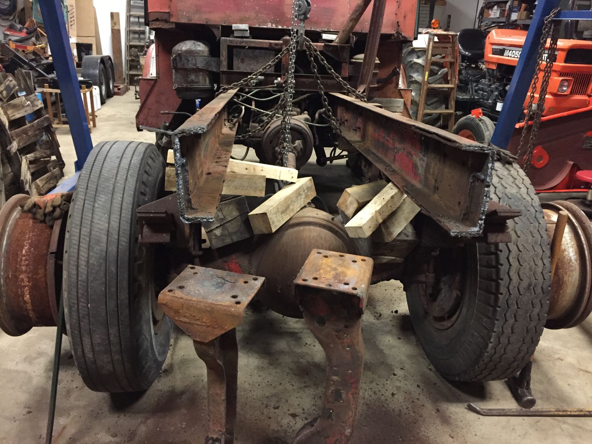

My crossmembers are damaged, so I wanted to steal one out of a parts truck...of course, the spring hanger/crossmember bolts were rusted and seized but good. They also hide one bolt in each hanger behind the leaf springs so you can't get a socket on it. Then, after I got the bolts all out, the springs were squeezing in on the frame so I had to lift the rails out of the hangers to get the crossmember out. This was a full day's job to get these things out! Notice the frame rail torch cut--someone added a Neway air bag axle years ago and they butt welded the frame rails as well as doubling them. I cut the rails behind the weld so if this frame gets used, it can be cut at the correct spot.

Seems vaguely familiar, in fact conjuring up old memories from the frozen locker..... Lots of torsional stresses in a truck frame you don't see until breaking it into component parts. I usually spread frame rails with a couple of 10 ton portapower units or a single 20 dependent upon task at hand to remove/replace xmembers. Looks like a real "cobble" job on the frame in the past from this vantage point but it obviously served the purpose over several years. That "twist" is easily relieved with a couple of towers and heat on the frame rack. Never a fan of "butt" welding truck frames unless linered or full pen welds are applied. I have a bevel machine that simplifies the task a bit:

That axle uses the same spring hangers mine did originally.
