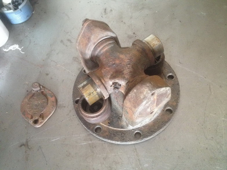

I have a "Tiger Tool" and it works great. Remove the bolts, push the joint to the extreme of one direction, tap with a chisel and remove that cap, flip the tiger tool and pull the joint fully the other direction. You can now remove the "cross" of the joint easily and a punch readily removes the cap from the other end of the yoke.
That is on a driveline I wish to put back together without changing the joint. One that is expended I just blow the cross out of it with a torch, warm the ears of the yoke just a bit, and push the caps out with a drift pin and hammer.

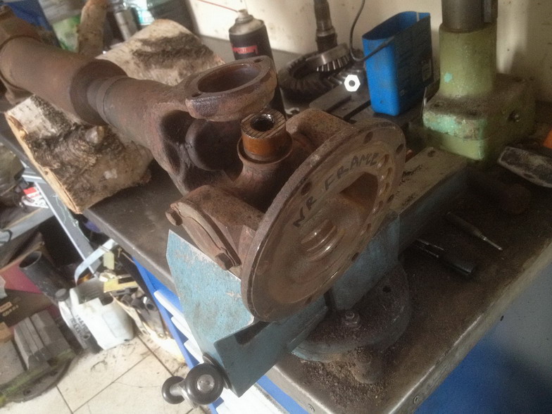

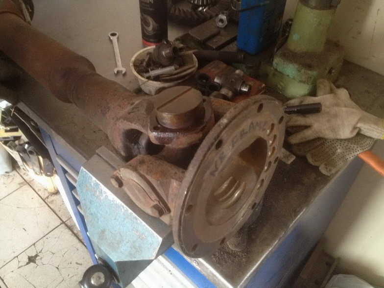

These were made in 1945 and went out relatively easy. And with no heat. Good thing someone greased the shafts in the past. Probably the last time in 1983 though. Pretty sure nobody ever removed the caps after they got in place at the factory.

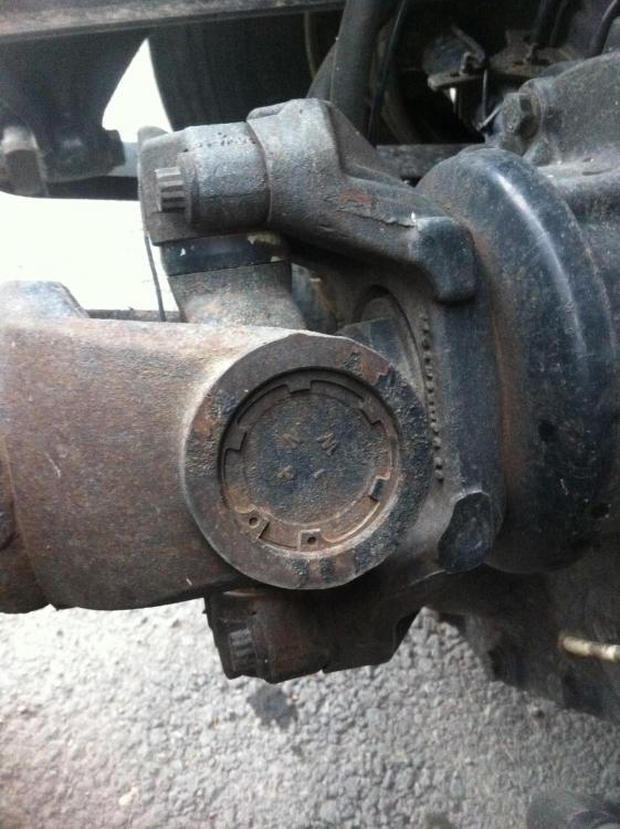

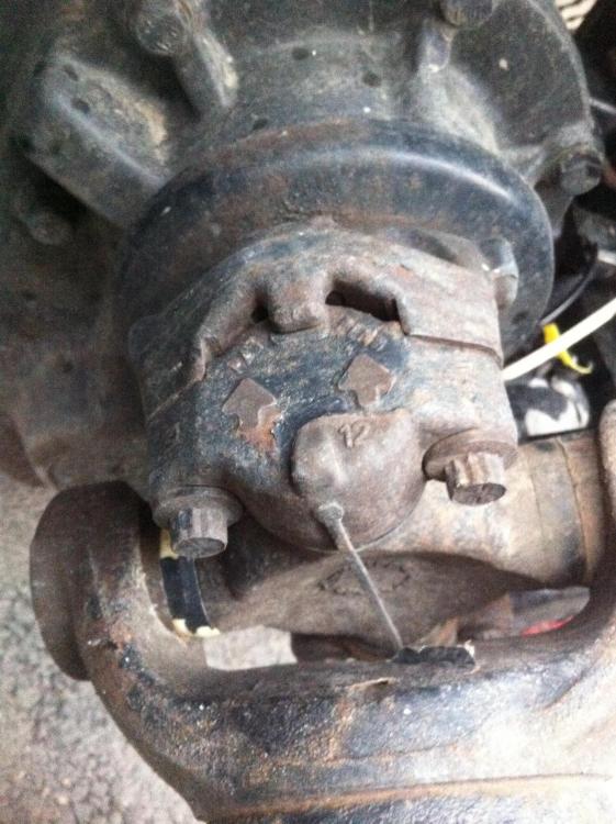

Doesn't look seated on the right land to me. Yoke stretch or spread can cause that.
Don't like working with those too much either. I always take a 5" grinder with a twisted wire brush, (very stiff) and clean the ears and seating area of the caps well so the new joint aligns easier before drawing it down.
What you will see with wear, (and the angle of the photo appears to display) is the right side land for the joint, (looking from rear towards front) is a gap. All the torque is absorbed through the right side of the universal joint mounting flange. As those flanges wear or stretch, or twist, this happens and you usually here the damage as a "knock" in the driveline between upshifts sometimes but moreso as a knock when transitioning from forward to reverse, vice versa. Slips and spline wears sound similar but higher pitched usually.
