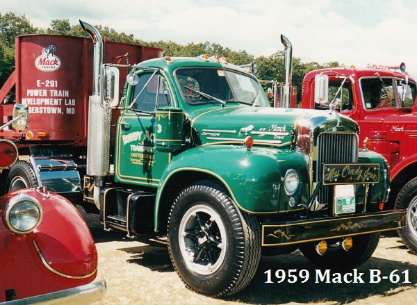

Back in the era of the custom gets what they want.  Here is a factory B-61 with contour back panel.
Don't remember seeing a contour back B-61 working, but do remember B-67's in standard cab back still making a living for themselves years ago.
https://www.bigmacktrucks.com/topic/53110-another-question/#findComment-396794
Right, B67 with either flat or contour.  Definitely more contour.
The B-61 pictured belonged to Millis Trans. and I just think it is an interesting combination. Must be the owner did the mechanical work and he wanted the full length hood!
