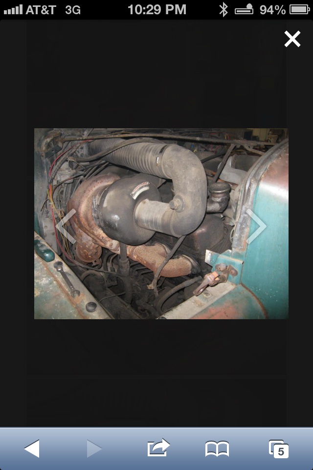

Couple photos of the exhaust on my B67:IMG_0353.JPG.b765a5fc77c6c14d20ed614a1f6cf4d8.JPG
Trying to show the "lean" of the engine in the chassis. Don't forget how the firewall of the cab is modified from a standard B cab also:
IMG_0357.JPG.7d2f68ec47a705055f00fc953c3b83a8.JPGIMG_0358.JPG.4ad8e3dd5dba8bac29acc13bc4ba578a.JPG
The firewall modification is why the engine has to lean otherwise there would be no room for a driver's feet.
Ugh-that is a Luber-Finer right?  Why would they jam that under the hood?

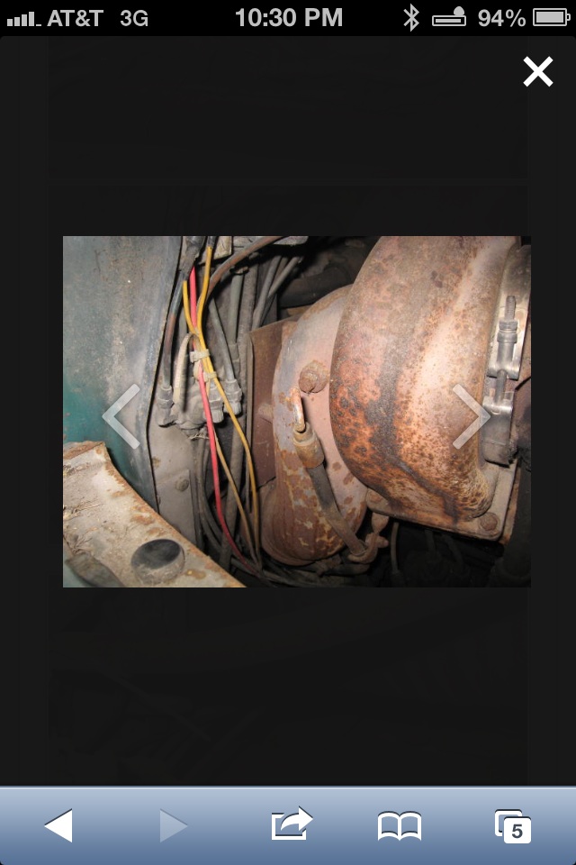

I checked the turbo on the donor engine this morning and it looks like it might fit
I hope that turbo elbow hasn't been open like that---you don't want any debris or water getting into the turbo.
