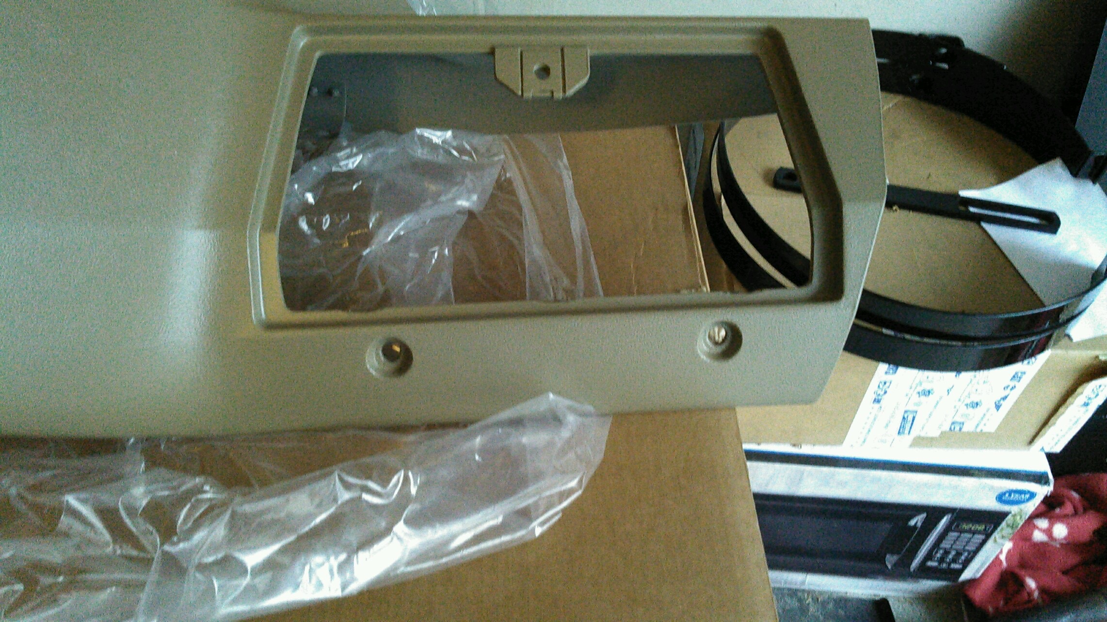

Bought the dash pieces for my r.  The original had tabs welded to the structure. The tabs are fastened under the dash support cross bar. The new panel has these 2 holes. Are there more parts to make this work? The bar has no other holes in that area.
Also does anyone know the part number for the hollow bolt like wiper washer fluid nozzles that mount on the cowl.

That is the newer hard plastic dash style. I have a donor cab out back and it's an 89 IIRC but I know it had a hard dash. I will look and see tomorrow what is there you may need.

I guess I was not the only one !!  get support # 25162389 drill the cross bar and bolt it if the holes are not in the right position, i went thru hell before I got the support bracket.
