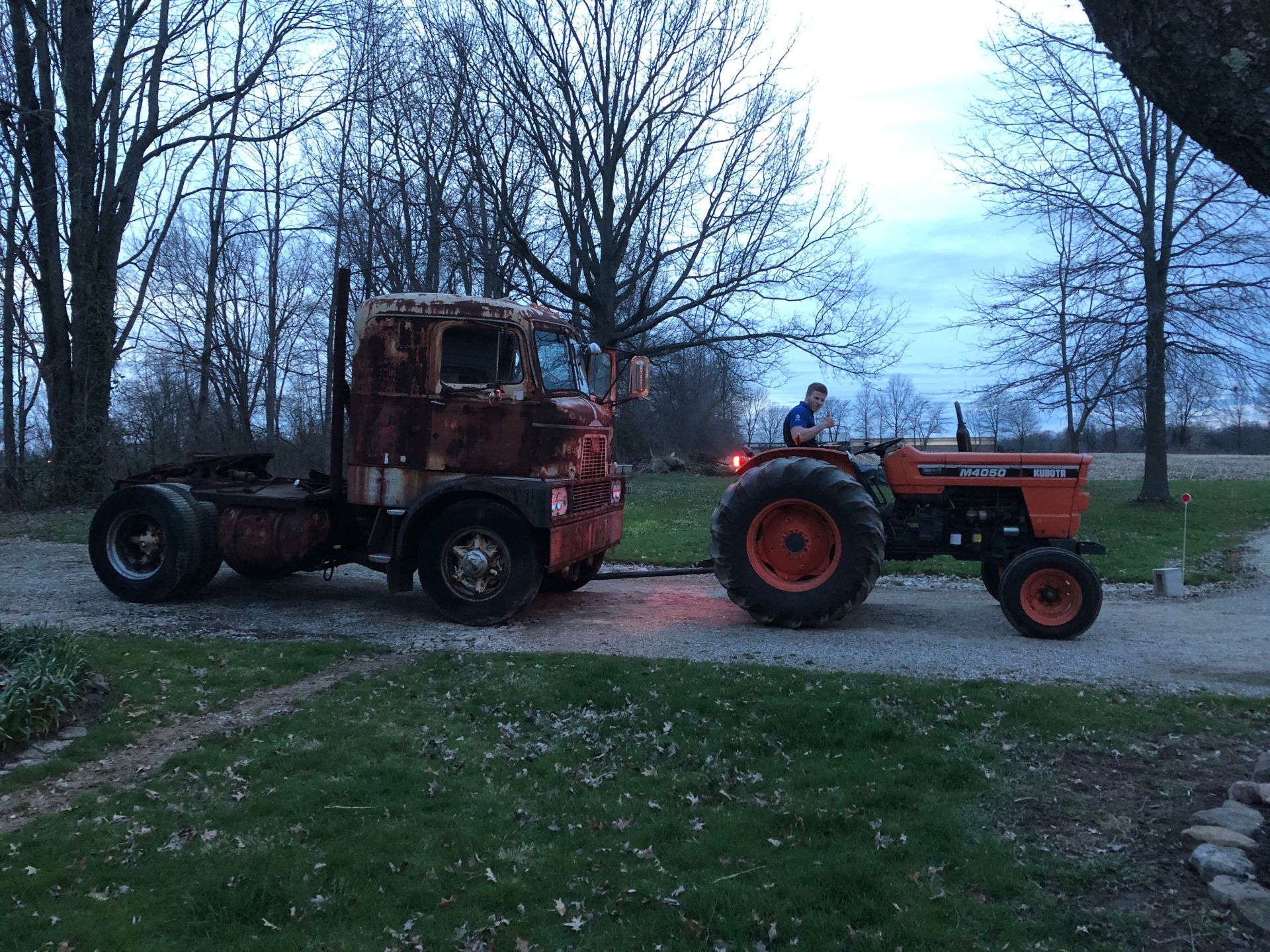

We can't get my H613 to hold air in the starter tank unless be drain the brake tank. What are your plans for that H67?   Mike.
The cab is completely gone on that one, there are almost as many holes as intact sheet metal. I'm robbing parts off of it to restore my tandem.
